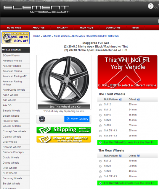

One site says the wheels I like fit and are $1000 a set. Niche Apex 20 x 8 5 10 Black M Rims Wheels Jaguar XF 09 Up 5H 35 | eBay
The next site I visit, says the same wheels are $1000 EACH [turns out they are NOT the same wheel as $250 rim is a forged 1 piece and the $1000 is a multipiece.] NICHE® APEX Monotec Series Wheels - Custom Rims
And the next site wants $1175 for 4 wheels but says they won't fit my car.*

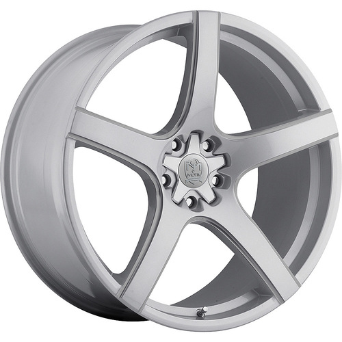

Black Pack - those Braelin wheels look really nice. I wanted and tried to find the OEM Takoba wheels but I couldn't find any used rears and the Jag price for new was $800 plus each, used fronts were available for $300 each. . THEN I came across these incredibly cheap 5 spoke wheels, 600 delivered for a set. We will see when they arrive if they are Ok.. I may have them matte powder-coated "brake dust grey" which is the color of my factory Dracos.
Motiv 410S Maranello - Free Shipping | TireBuyer.com

Hi Gn4hir - those Motiv wheels seem incredibly cheap at under $600 for 4x wheels. I'd love to see photos once you get them and to hear your views on them. Are you getting 20 inch? And what are you doing about bolt pattern - if I read their website correctly they are not in 5x108 bolt pattern so are you doing something to get them to fit? And are all the offsets ok for an XF?
I'm still interested in a second set of 20inch wheels for my winter tyres to avoid paying every 6 months to remount them. If these work (and there is a staggered setup to match my winter tyres) then I'd certainly be interested
