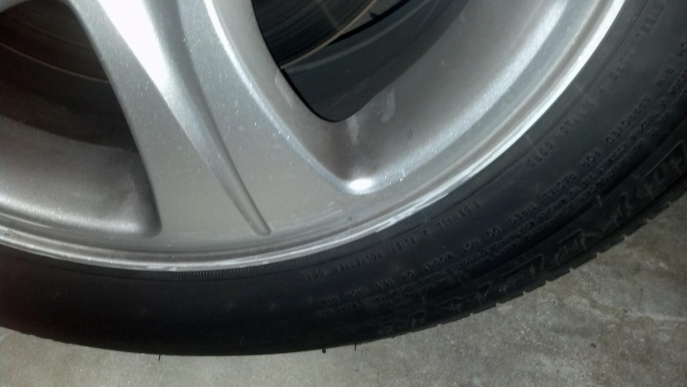

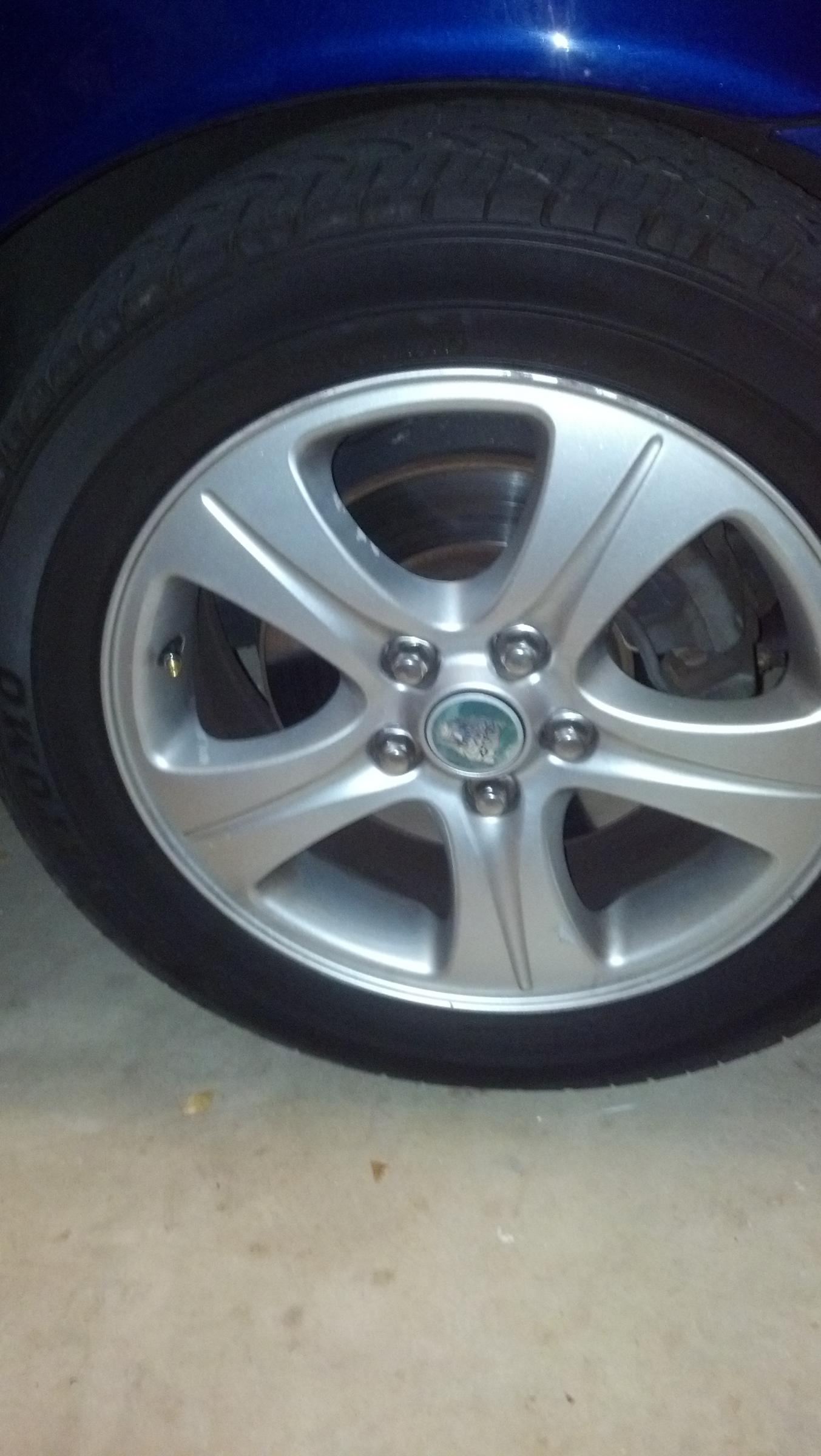

Default Minor Refurb of Rims
I have an 02 X-Type that had a bit of road rash on the rims from when I bought the car. I tried an number of things and found that a dremel type tool with a while stone bit worked really well to get rid of the rash. Then I used 600 grit and 2000 grit to smooth out where I had ground them down. They look great. Now all I need is to match the paint to do some minor touch up and they will be like new. I used this same process on my daughters Acura and then sprayed clear coat on them. While they don't look new, they look a LOT better and from ten feet away or when they are moving you can't see anything wrong with them. Otherwise the shop around here wanted $100 per rim. The first picture shows just after I started, hence the smooth spot at the top in the middle of the rash, this is where it was the worst. The next two I just took and as you can see, no road rash. FYI the part at the top in the first pick is where I zoomed in on now at the bottom right.

It is important to repaint the bare aluminum to impede corrosion. Aluminum corrosion is only cosmetic but ugly.

Ah, thanks for the tip. I will be sure to clean then really well and apply clear coat.
