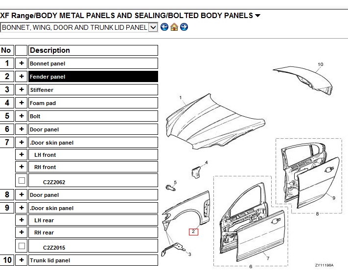

My choice would be to go 'used' parts from a breaker as suggested by 10 XF Premium and axr6.
Alternatively, if it's only panel damage and the door shells aren't compromised, skins are available from Jaguar (see items 7 and 9):
When sourcing a new or used fender, note there's a VIN related part Number change:
to VIN R40098 : C2Z4033
from VIN R40099 to VIN R40574 : C2Z10446
from VIN R40575 : C2Z14005
