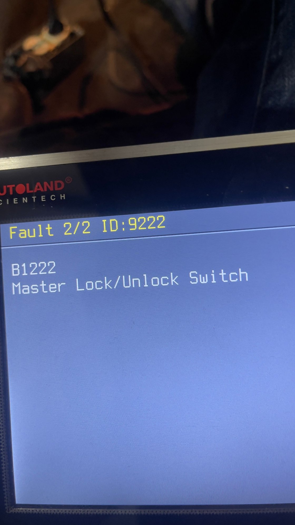

You need a better scanner. There is another 2 digit code at the end of that one. Something like 23 or 13. B1222-xx

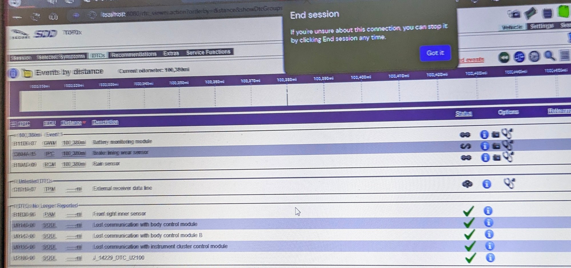

-The only codes we have showing now are
B11db, u0142, u0010, u0422, u0155 u0140, c1b00, u101b, b1087,u0103, u3000 ,p2542
-We have cleared the codes and now we are only showing codes for body control module and low pressure fuel system sensor circut high

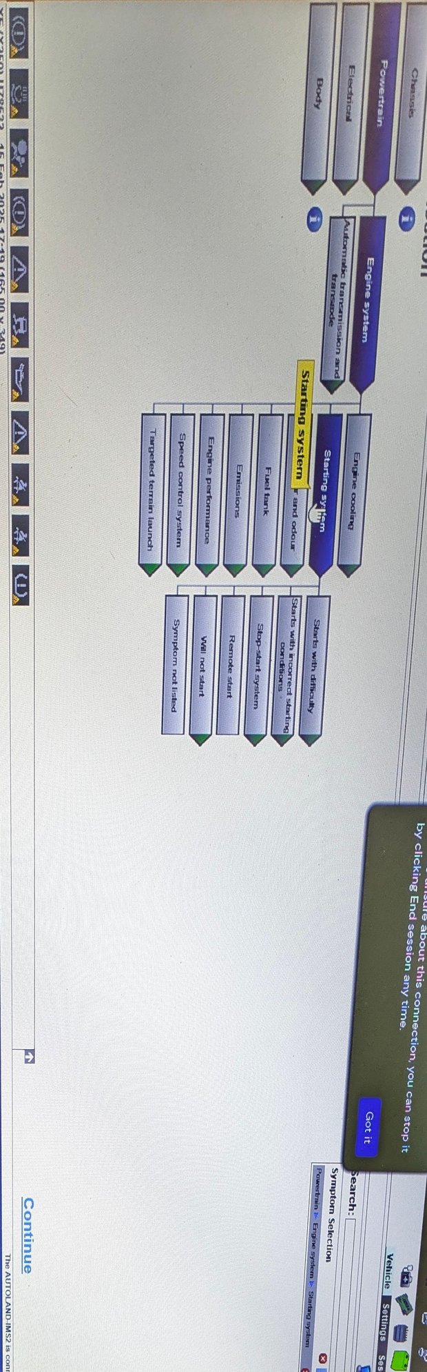

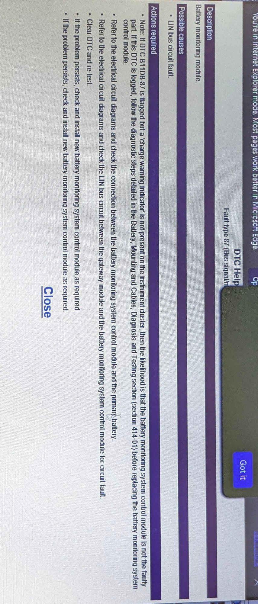

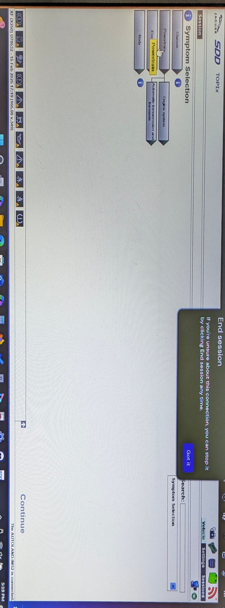

Okay so update on the XF 2.0. we had a gentleman off of here help us with the modules and some of them did need to be reprogrammed again so he was able to do that for us. We also replaced the wiring harness. The vehicle is still not starting unfortunately. Now we have a code popping up that is saying Master lock and unlock switch which is b1222 so does anybody have any advice whatsoever? I cannot afford unfortunately to reach out to the gentleman who was helping us. Unfortunately this car has made us severely broke and with me not working because it's broke down. I'm having to pay for rides everywhere so it's costing a lot of money we need to get it running.
Everything we replaced it at one point had a code for . I will post pictures of what add is saying now. We do have proper sdd and it is working but unfortunately we know little about what we are doing for this vehicle Jaguar is not one we get ever and we dont usually do anything programming.
