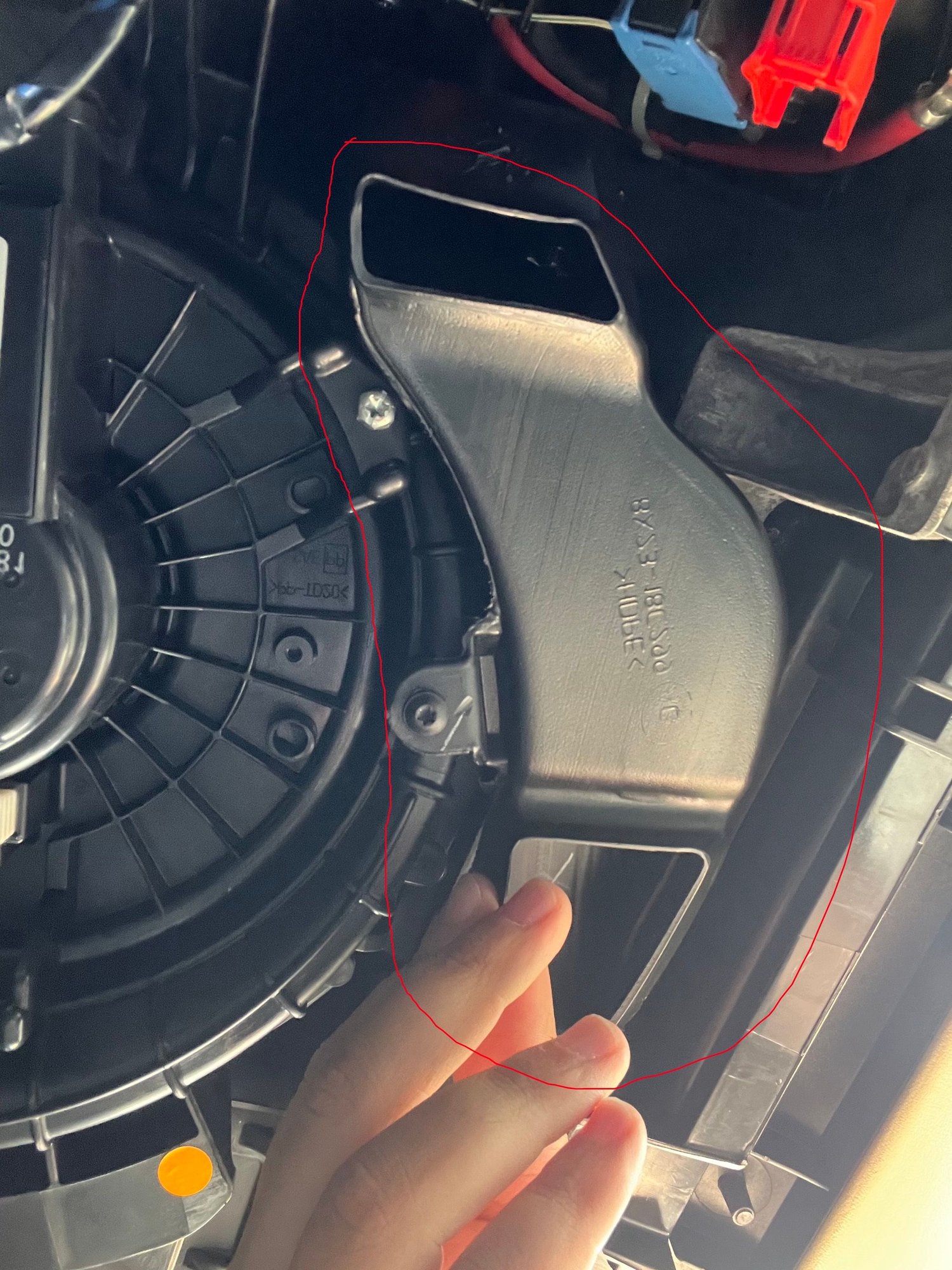

I think it fixed the electrical part of the problem. The caps started closing and opening properly. Will drive it for a day today and get back to you with my feedback. Why did I not pay attention to your previous message earlier... I was in rush and panic that time and missed it. :/
The funny thing is that I fixed this problem and created a new problem ) I accidentaly touched the "hose" and it became now loose..And air isn't going through it anymore... Is this something that could be fixed just by taking the dash off?

Remove the screw visible in your picture and take out the air duct. You can then see how to re-install it. Maybe it's been removed before and not put back correctly?
