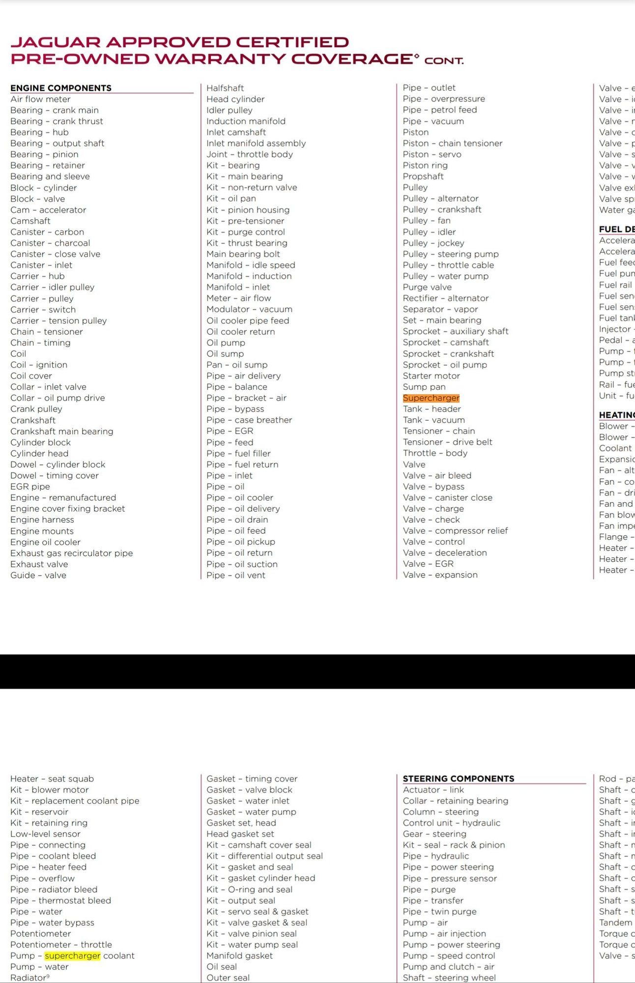

Jul 13, 2019 | 08:20 PM
Here is a link to the included list in the Jag CPO warranty
(Not the letter at the top that states some exclusions, but the rest of the pages)
Supercharger is absolutely included in CPO
https://www.jaguarforums.com/forum/f...n-list-213059/
Try a different dealer although I expect they will see it on the records
But I still can't understand how a supercharger issue isn't covered by CPO. You should escalate in Jag.
