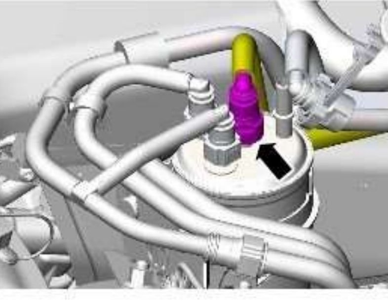

You should be able to hear it clearly with back seat and cover removed, I can hear the hum of mine from drivers seat. You can test if diesel is making it to the engine bay by removing the center hose on filter, it will pump out of filter fast if pump starts so best to put a piece of fuel hose on it and in to a bottle, worth checking how clean fuel is too, mine somehow had black bits floating in it. The car didn't appreciate it much funnily enough..
