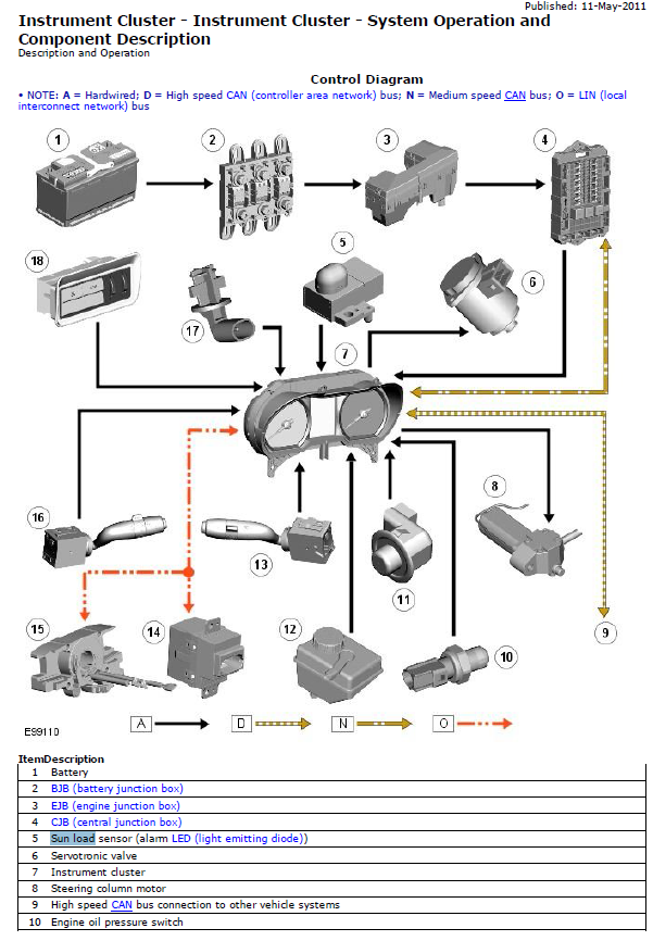

Which light sensor was replaced, there are multiple. The ones in the mirror can be ignored for this. The security LED does have a light sensor in it, details from service manual. Not seeing anything specific to navigation dimming, but there is a blurb about the center message LCD brightness being controlled by the sunload sensor, so it is plausible that navigation is tied in the same way. This sunload sensor communicates with the instrument cluster directly according to the diagram.
There is also the rain/light sensor stuck to the windshield where the mirror is mounted, but that seems meant for exterior lighting, the automatic headlamps. But anything is possible with this car.
The message center LCD illumination is controlled by the sun load light
sensor located on the instrument panel. In bright conditions, the illumination is set to maximum brightness. As the
ambient light levels drop, the illumination dims. When the lights are switched on or activated by the 'AUTO' function, the
illumination operates in the same way until a defined ambient light threshold is reached, at this point the setting of the
panel illumination dimmer in the auxiliary light switch will control the brightness.

Many thanks for the replies. The service manual info really helps, litteredwithfaults. It seems very likely that the sun load sensor is the one that controls the Navigation screen since the message center LCD illumination no longer dims with the thumbwheel as it used to when the Navigation screen Auto mode was working. I will find out which sensor the dealer replaced. Assuming they replaced the correct sensor (twice!), it seems like something else is wrong. I asked whether the new sensor needed to be re-calibrated, but they stated that it did not. I will report back.

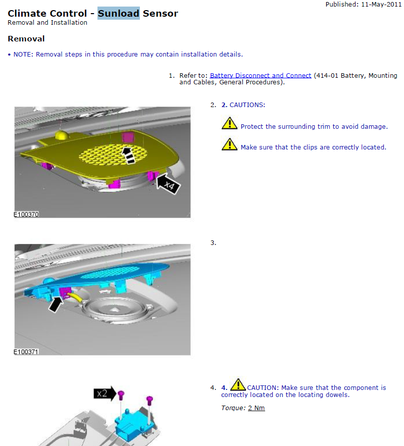

does the sun load sensor replacement require removal of the top portion of the dash? coincidentally i am having similar issues with my car thinking its night all the time. and i have the bubbling leather. maybe i can convince the dealership to take care of it and fix my dash
It can be accessed through the center speaker cover. Which is very brittle and nearly guaranteed to shatter. $$$$

but even if the speaker cover breaks, they can still only just replace that cover. not touching the leather. hmmmmm
well, you were right...they broke the speaker cover. now i gotta deal with them to fix it
