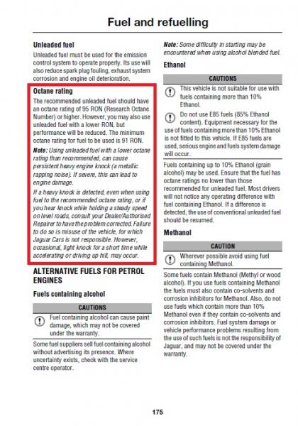

Here is the XF Fuel requirement advice from the UK Driver's Handbook. I've outlined the section on lower octane in red:
Lower grade fuel gives reduced performance but short term use of lower grade fuel should not cause any damage.
The Note gives a warning about engine 'knocking' which can cause damage.

Note that the recommendations given by Jaguar and posted by GGG mention octane ratings using the 'RON' designation (research octane number). Gasoline sold in North America uses the AKI (anti knock index) rating system which is quite different and confuses many owners.
A rough conversion :
95 RON = 91 AKI
91 RON = 87 AKI
so operating your car on 87 is acceptable with a caution that max performance may be reduced. Many of us 'S typers' run our cars on 87 with no noticeable affects at all.
Hope life on LI gets back to normal soon.
