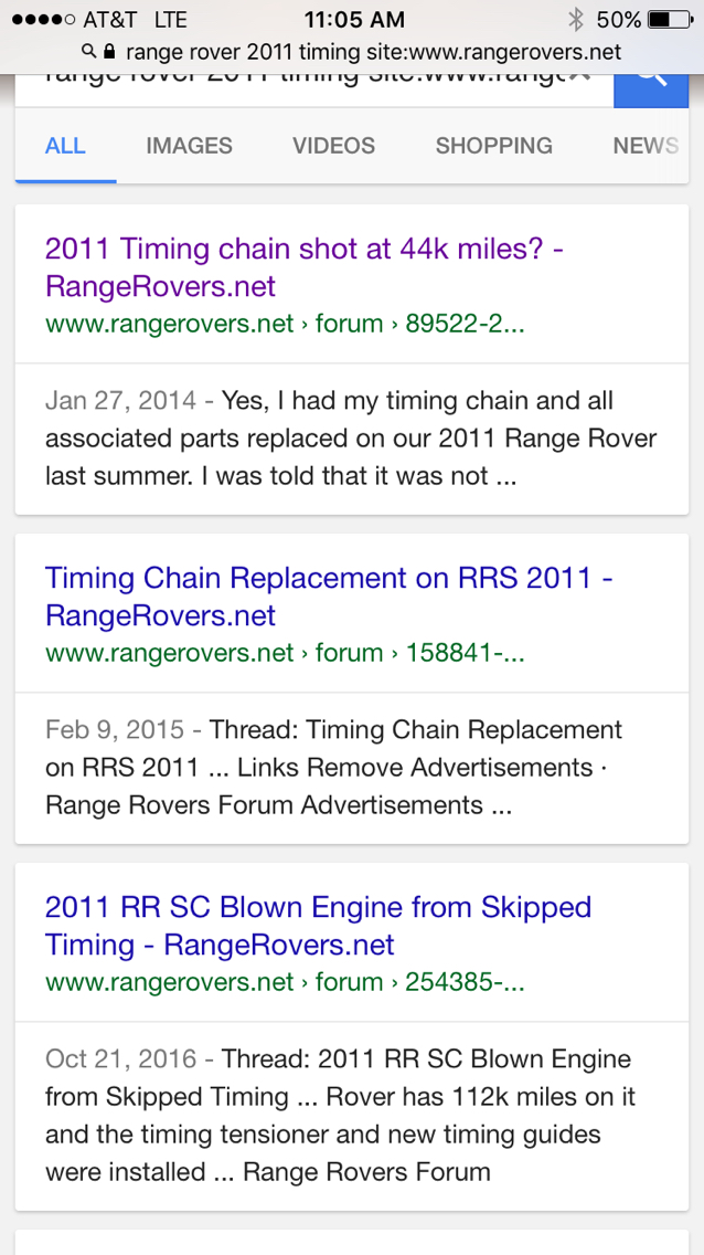

You need to check Range Rover for this period.
All over the place in that forum.
You can say different factories, but truth be told they share parts all over. You are splitting hairs.... my point is there is a problem. It could be a coincidence that the same years as Ford and jag/ Rover have problems. My guess is shared tensioners and possibly guides.
I would advise an oil change from the pan, so you can check for particles. I've done mine through the top via vacuum and it really doesn't allow you to check the oil.
