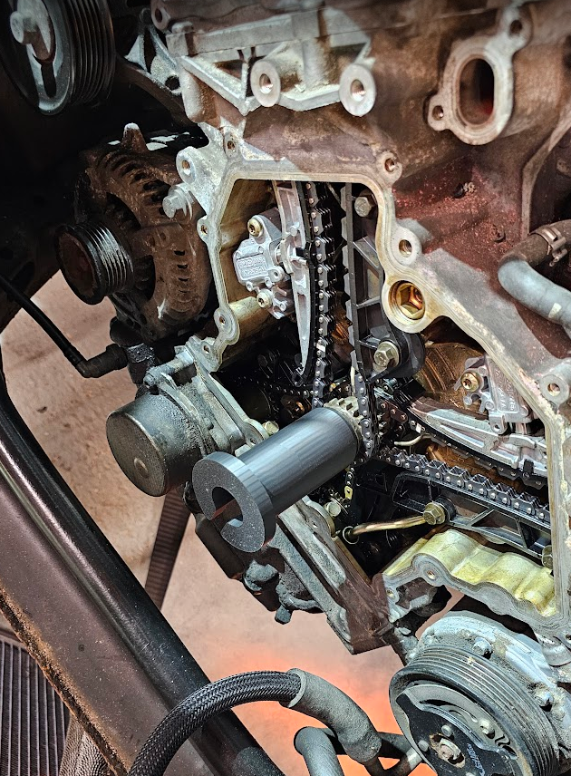

Old Jun 2, 2025 | 05:25 PM
  #71
RobThe****'s Avatar
Joined: Jun 2023
Posts: 19
From: Surrey, UK
There is nothing to adjust if you are just changing the tensioners and guides.
If you are doing the chains too you have to have the rocker/valve covers off which means removing the injectors, in that case you lock the timing with a timing tool - a bar(ish) tool that slots into the cams at the rear of the engine. Again there is nothing to adjust. Its not a fun job at all, especially with the engine in the car and in an XF.
If you've skipped a tooth you will need to go the whole hog and pull valve covers so that the timing can be reset with the chain off. If you haven't skipped a tooth you can get away in most cases with just doing the tensioners/guides. Yes the chains do stretch, I have before and after pics if anyone wants them however the main issues are that the tensioners wear into the guides and also that the tensioner mech/ratchet which is there to keep some tension when there is no oil pressure (start up) fails.
On my XF the chain on the UK passenger bank caught on the oil suction tube (the one under the oil cap), it bent the oil suction tube and caused the chain to skip a tooth... unlucky but I bet the chain was making plenty of noise before that happened (I bought with a gone chain and EML on). My Range Rover with this engine is starting to make a noise similar to the 'clonk clonk clonk' mentioned at the start of this thread, I'm hoping to get away with just tensioners and guides.
I would strongly advise that anyone with timing chain noise and no EML get busy and do tensioners and guides. Skipping one tooth is a problem, skipping 2 teeth is a much bigger problem.
Old Jun 3, 2025 | 12:31 PM
  #72
kansanbrit's Avatar
Joined: Dec 2013
Posts: 978
Likes: 275
From: Kansas
I have actually had good luck correcting the timing after it slipped by putting the cams back into the correct position after referencing photographs I had showing the correct orientation of the VVT sprockets.
Old Jun 9, 2025 | 07:35 PM
  #73
RobThe****'s Avatar
Joined: Jun 2023
Posts: 19
From: Surrey, UK
I did consider this while mine was in bits, my issue was that it was a lot of work even getting to the chains and I was on a fairly tight deadline so didn't have enough time to do the job twice... this was also my first chain and originally I thought the VVT spanner step was pre tensioning something inside the phaser somehow - while in reality it just making sure the chain slack is on the correct side. I think with an inspection camera you could perhaps also see the marks on the top sprockets. As it happens I'm happy I went the whole hog as I found someone had removed one bank of injectors before and damaged one, they had also refitted without replacing the teflon seals.
Perhaps next time I'll risk it. My XF had been neglected on oil changes, they had been done each year but not with the correct oil, I found my original chains to be quite stretched compared to the new ones so perhaps my threshold will be how close the chains are (at their closest point where the tensioner is).
I also forgot to count links!! A good way of resetting timing with the injectors in might be to count links up to the top sprocket timing marks... Oh well.
