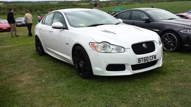

http://s3.photobucket.com/user/JTDamo/media/20150517_1432271.jpg.html?sort=3&o=4i buddy,
i have XKRS wheels on my XFR and they fit perfectly.........quite a bit more offset poke but IMO look better for it.
