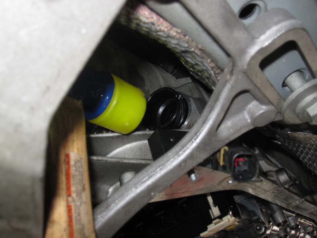

Making sure I could unscrew the fill bolt. That was a bitch. I broke a 1/4" wrench. The tool in the pick is part of a tool set I got at Lowe's.

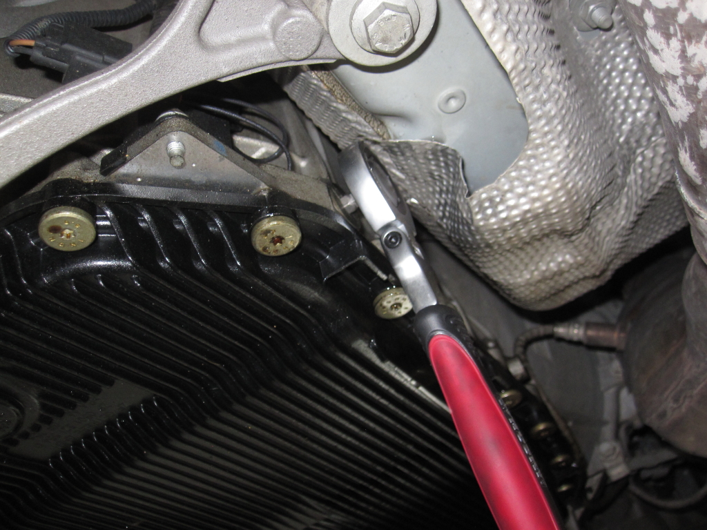

Removing the bolt pans - Torx T27
Pan removed

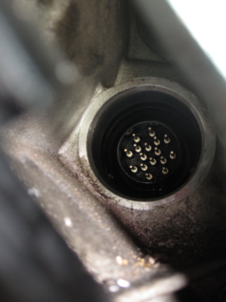

Ah, the sleeve. That was a bitch. That is the new one. Getting the old one out is not really a problem
Comparison of the old and new sleeve
Sleeve removed
I tortured myself trying to slide that in by hand but it would not go all the way. And you will know that since the sleeve lock will not budge from its open position. You have to be careful. It only goes one way. Despite that, I had to nudge it in with the help of a small rubber mallet

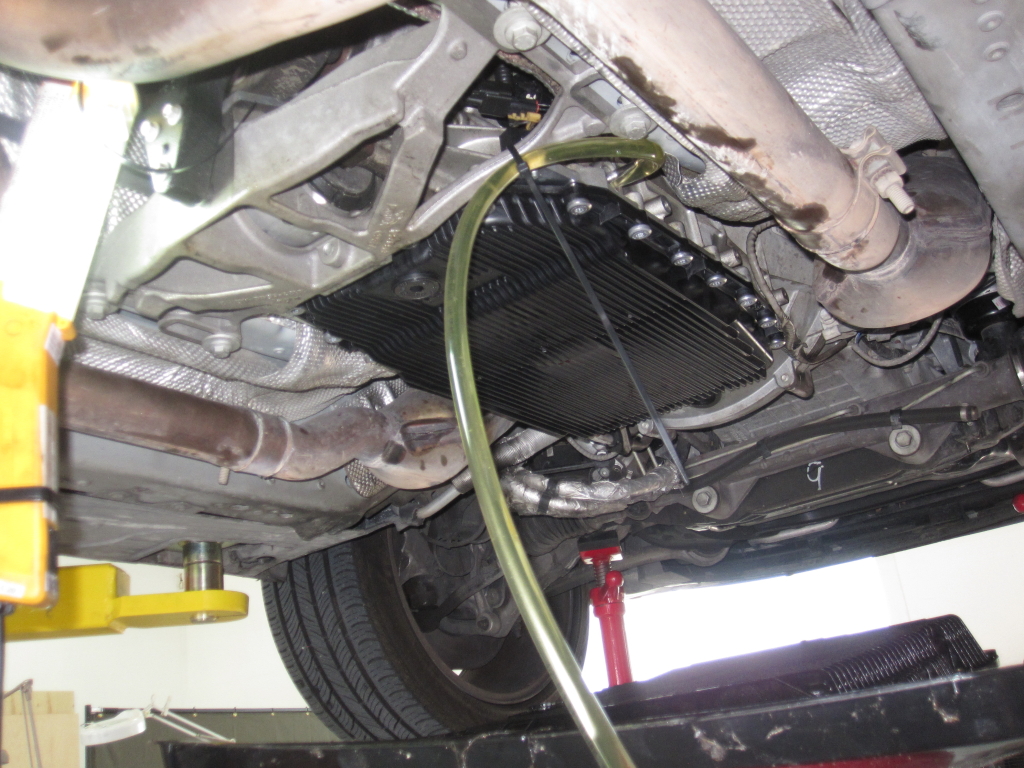

A $7.99 pump from Harbor freight paid for itself many time over! This thing was awesome. 4 pumps for each half liter...
So I added 3 liters of the ZF fluid, lowered the car, started, shifted between R, D and Park as described in the manual, lifted it back up and it only took 0.5 liters more at 35C temp (using infrared thermometer). So total amount of fluid was 3.5 liters.

Nice pics and very clean car underneath, I'm impressed (btw, you both use a lift and jacks for safety, good precaution!).

Regarding the removal of the sealing tube (Lagonia's PIC #5), the manual says to reposition the locking device then disconnect the electrical connector, then remove the sealing tube (what we all refer to as the sleeve.)
I believe the locking device it's referring to is the white piece of plastic in pic 4?
If so, does it pull down somehow?
