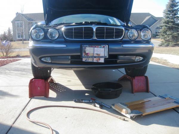

Drive the car up the ramps.

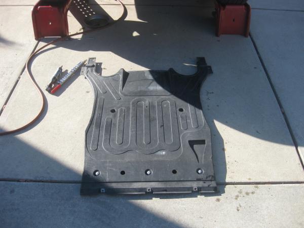

Remove shield that covers bottom of the vehicle using the ratchet and 10mm socket. There are three bolts across the front, two nuts in the middle and two bolts on each side at the rear. Once removed it's simple

When remounting the shield, attach it on the centrally located studs with the nuts FIRST and do not tighten completely. This holds it up and makes attaching the bolts to the holes in the frame easier. To allow adjustment attach all the bolts loosely to frame and the shield, then tighten all shield fasteners.
