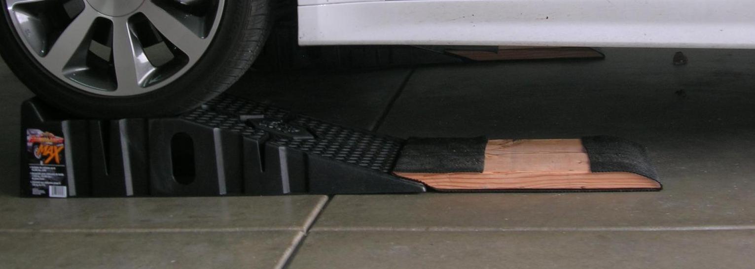

well I can't quite picture how the wood helps ramp usage, any further guidance?

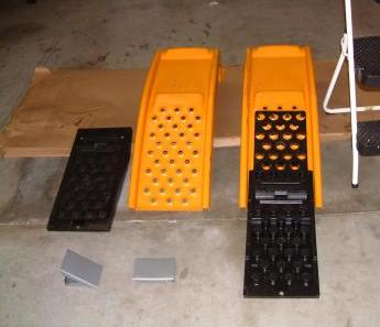

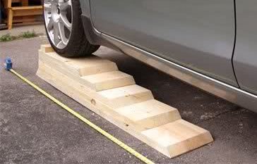

Blocks of wood wise if you take a foot of 2x4 and place it on the first or second rung of the ramp it'll lift up the front of the car as you drive up onto it before it meets the higher bit of the ramp
reyesl

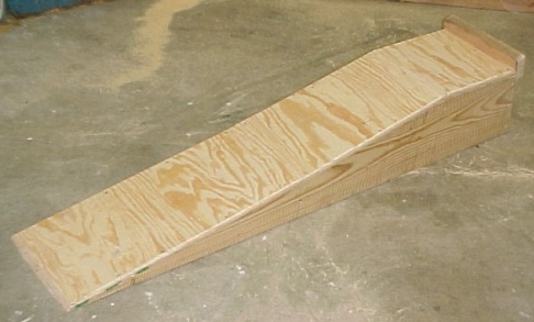

thanks for the photos. I have ramps just like the yellow ones in the photo and scrap 3/4 inch plywood to make the lead in ramps. But you have tried and made all the options. Oil change planned for the warmer weather, with ramps!
RyeJag
RyeJag
The store ramps didn't give me the clearance I wanted. I found out why when I decided to make my own. To get the height, you need a gentle slope, and it has to take the load! I also wanted to disconnect the ramps once airborne for access. Yep, this all adds weight so my ramps weigh in at 90lbs each. Probably over engineered, but i am under the vehicle. And thats why you can't buy them at HF or Walmart!

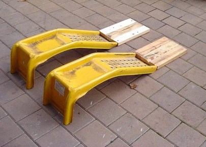

I got those yellow ramps too since my first vehicle back in the early 90’s. 20 yrs later still in service for the Jag. I will be adding a 3/4 plywood to make the clearance.

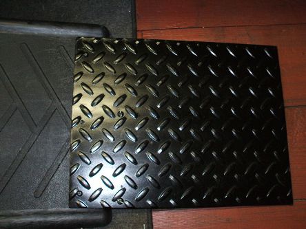

I have an XKR and the XJ8 and both of them hit the ramps I had, damaging the front bodywork. I found a better ramp that is more gradual from Race Ramps at Amazon. These foam ramps are longer and more gradual and the problem is gone. I like that they are also very light and easy to use.
