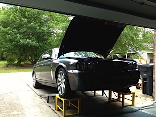

One important thing that you forgot to mention. These cars are equipped with air suspension. Whenever you get under the car, make DOUBLE sure if the air ride collapses it has enough room to colapse without crashing the owner. Nobody thinks of this. My airstrut failed and I assure you that car goes right to the ground!

Any reason why the car can't be raised with two jacks and jack stands? Then don't have to worry about air suspension.
Not any reason at all, used two or four with stands on mine for various jobs.
A lift would be a lot better, but cost always seems to be a limiting factor.

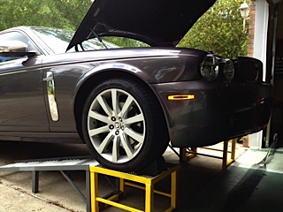

3. I appreciated the discourse on ramps. For some reason, the XJR has a tendency to push the ramps instead of mounting them. I'm not sure it's a clearance issue, because even with small wood blocks placed before the ramp section, the car still plowed rather than mounted when it reached the ramp section. I ended up having to use 2x4s to brace the rears of the ramps so they couldn't move backwards. FWIW I use the plastic Rhino ramps, so maybe it's a lack of ground friction, but my big BMW, Audi and Touareg have not had this issue. [Also, great tip on remembering to use jack stands while under an air suspension car.]

1) Firstly, echoing an earlier post about the Rhino Ramps just getting pushed around. Took me multiple attempts and finally had to wedge them against the edge of my slab to get up top. I will be blocking them against some lumber braces next time, or just build my own that are longer, more gradual, and taller. Tight fit under there!
