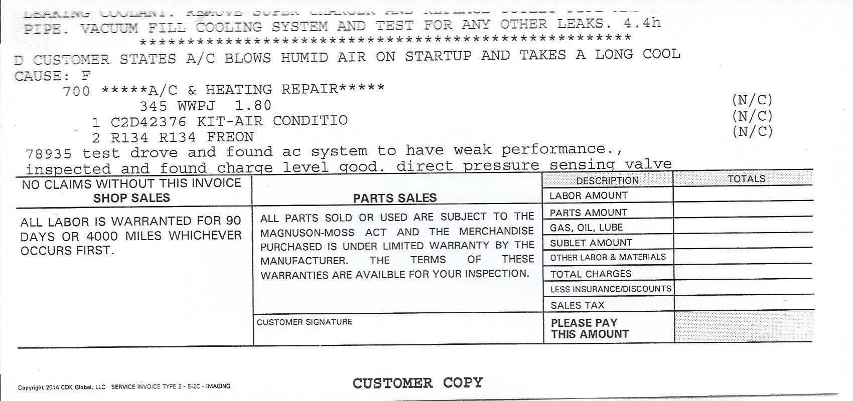

the guy that did the AC service suspected a bad condenser, but reading the factory repair PDF and my own experience leads me to think it’s the expansion valve.

Thanks for the TSB, I’ve heard of it but for some reason thought it was an issue in the XKs. I’ll give it a shot, $90 part and a few hours is better than ripping the dash out of the thing!
