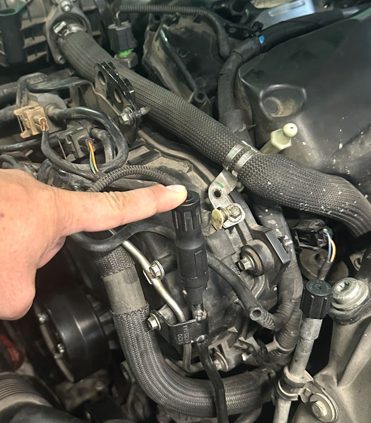

You are referring to this pipe. And there is a special something to connect to it? Or just a propper hose…. 9 mm diameter you referred?
Is there any special funnel to pour the oil in the engine after? New oil? I am really bad with filling up the new oil….. And I hate spill on the engine

Yes. That is engine oil extractor pipe. It goes down to the oilpan. (on V6 and V8 petrol thats under oil cap) You just connect the pipe of the pump on that. Some pumps come with an rubber adaptor like SuperChargerXJL linked. If not, just an short piece of silicone or rubber hose about same diameter is needed to connect pipes together.
I know the pain filling up. Been learned to fill directly from bottle without making a mess, but you can use any universal funnel of your choise. Just make sure its clean! All you pour in will go thru oilpump once without filtration.
