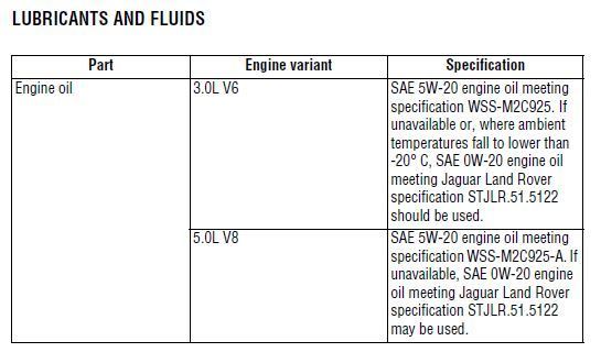

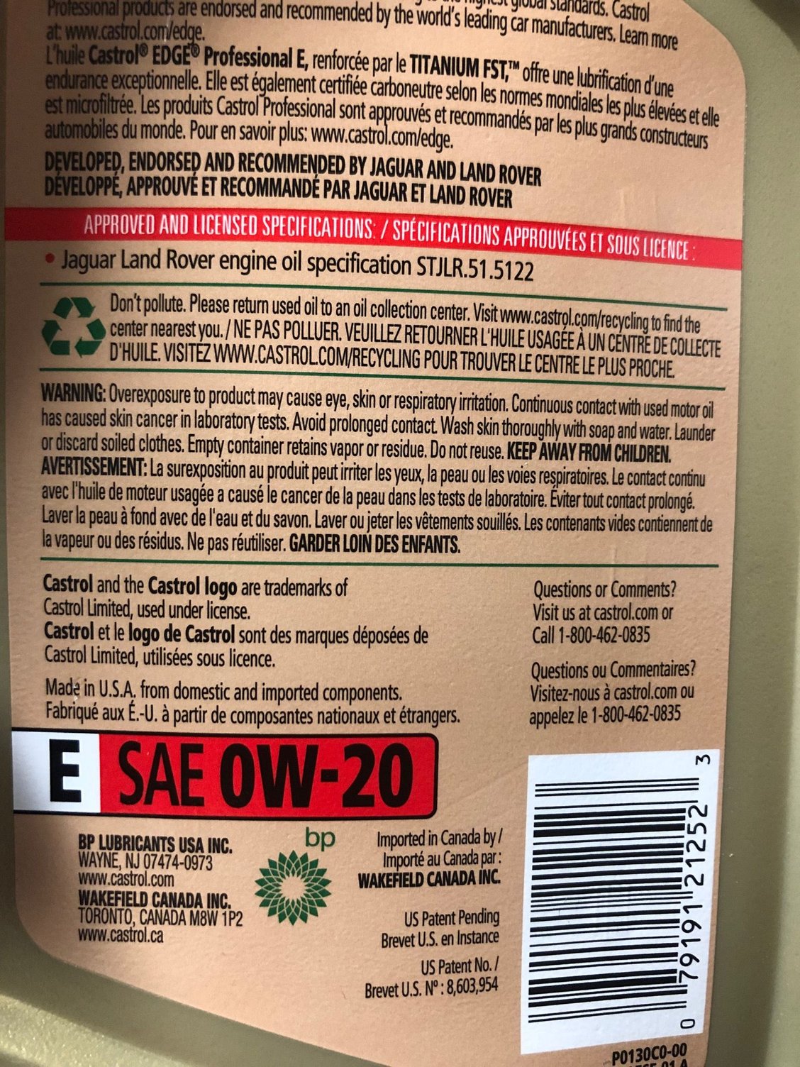

Originally Posted by FordGuy62
Thanks... maybe that is peace of mind. Sounds like we're hearing the same noise under the same conditions. And low on the driver's side is where mine seems most audible, too. I wonder how many others are hearing this? I've been around a lot of cars in my life, and that sound has never been associated with a normal condition.
The dealer doesn't think it's normal and was ready to tear into it to the tune of $7,000+. I only took it to the dealer because I had a SRS recall and while it was there I asked for a diagnosis. Nothing conclusive, they "think" timing chain and tappets, but that isn't a definitive diagnosis and they admit it. Sounds like a shotgun approach to me. I'm suspicious of tappets being the cause. If it has to be torn down, I will do it, but I hoped it was something they had heard before and could point me in a direction. Most of the knocking I've read about is related to the S/C engine and, as I said, mine is N/A. The fact that it goes away when oil pressure builds leads me to believe that something is bleeding pressure off when it sits warm. When it cools down the tolerances tighten up and it isn't audible.
Regarding the next post and oils, yes, Castrol meets the spec. It's not the oil.

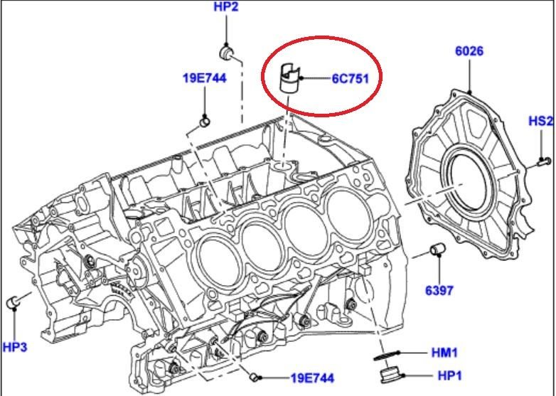

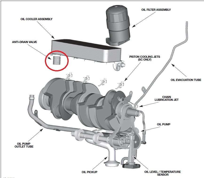

There is an anti-drain back valve that could be leaking?
When you remove the oil filter on top of the engine there should be a puddle of oil standing in the housing. If not that is a prime symptom of the drain back valve failure. It's not reported much but thought to mention it just in case.
The valve is mounted under the oil cooler brick. Inside the engine block.
Here is what it looks like after you remove the oil cooler brick.
Not well documented either.
