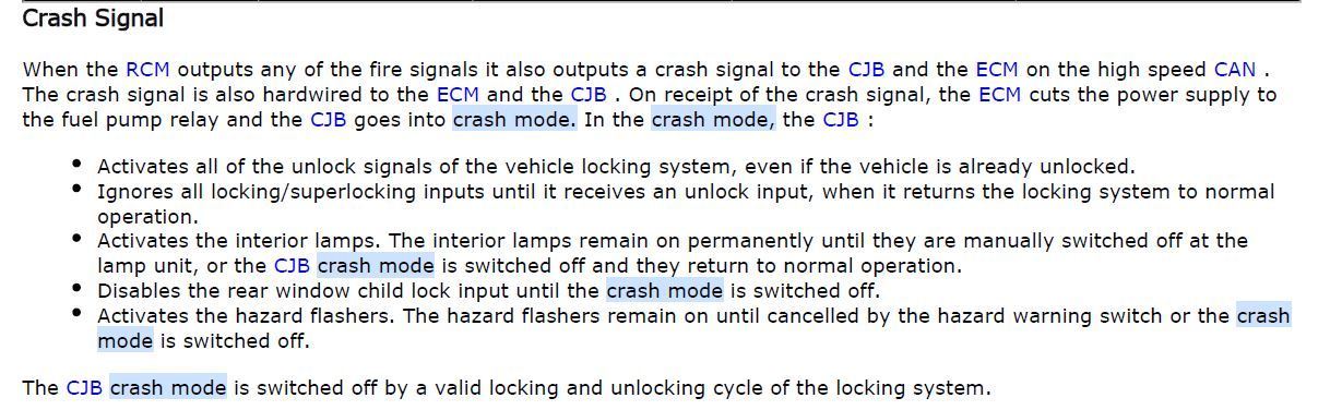

Correct. Crash mode!
So it does cut off the fuel pump like the old inertia sensors but also sets all kinds of stuff thru out the car.
I "think" you will need to get the CJB out of "crash mode". They claim a valid lock and unlock cycle will reset it?
Maybe the ECM too since it also receives the "crash signal". No indication in the manual how you do this either? I have not done this and will assume that SDD is required.
