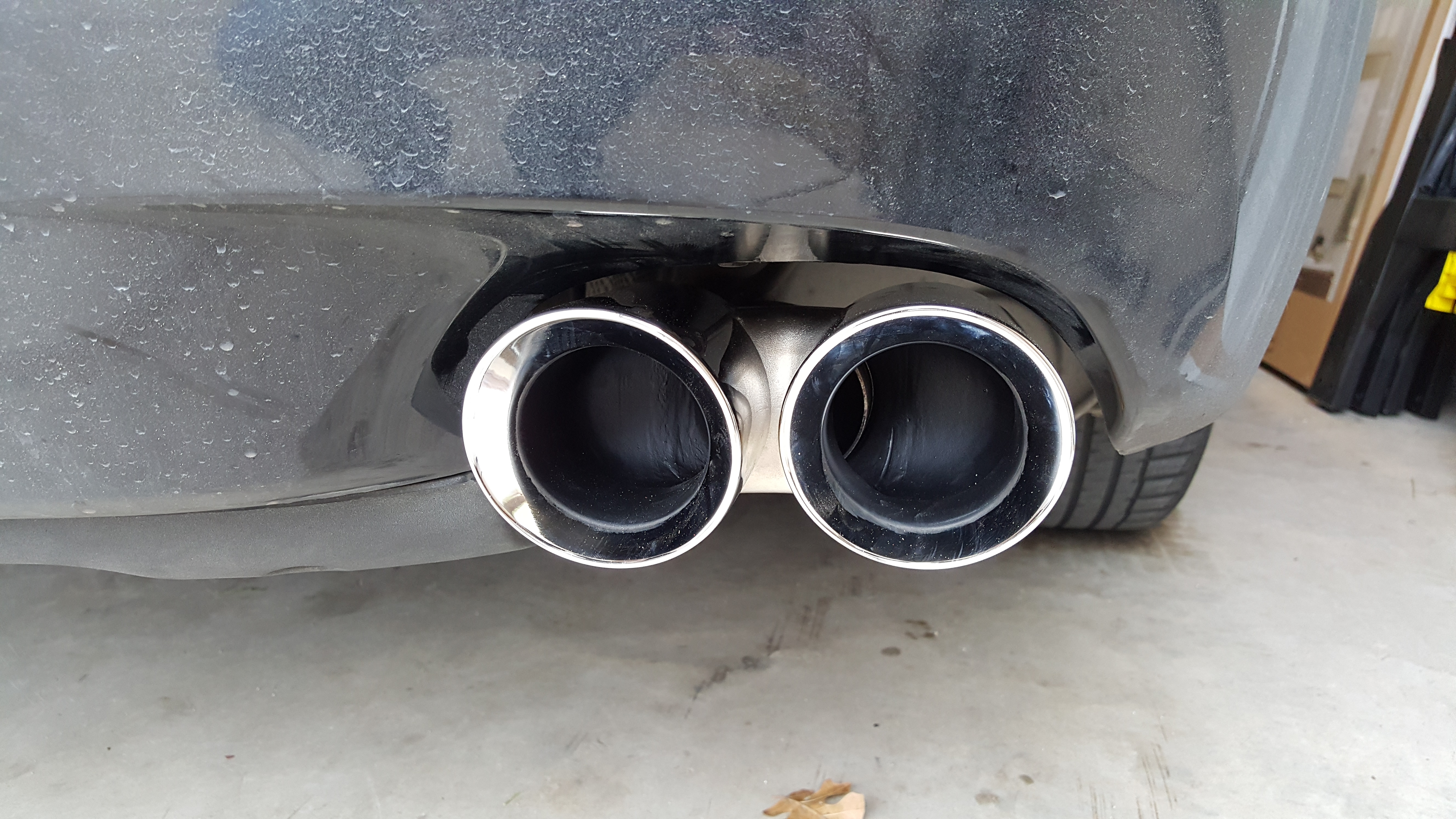

I bought these for $240 (made an offer):
http://m.ebay.com/itm/PORSCHE-997-MK2-QUAD-EXHAUST-TIPS-FULL-STAINLESS-CHROME-BOLT-ON-997-2-CARRERA-S-/161343769695?nav=SEARCH
To install you will need to file down the inner sleeve/cuff which comes out so its easy to do. Took about 15-20 mins total to file and install both sides.
You can see the inner sleeve, thats the part that needs filibg on the outside. The ridges need filing down to allow it to fit, 59mm vs 60mm factory.

They actually shipped from Taiwan with international express delivery even though the seller is "UKStylings". I placed the order on the 12th and got them on the 17th, they were actually scheduled for the 16th but carrier took an extra day for some random reason. I will try to measure the pipes tomorrow and let you know. I have attached another photo so you can see the fit in the bumper cutout. I thought they looked a little large initially but it was just because I wasn't used to it and the car was dirty so the chrome finish stood out so much. Personally I like the look of these better than the stock quad exhaust on the XJR, stock seem a little small and also stick out too much but that's just my opinion.
