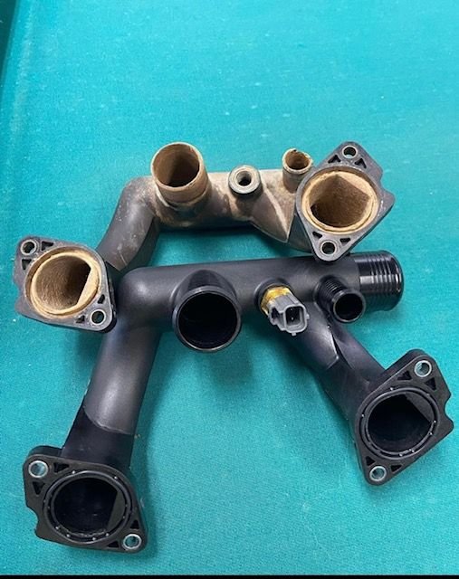

Hello there! I write service and manage my family owned Jaguar repair shop and in our experience, the 3 and 5L engines usually begin to leak coolant at the heater manifold and coolant outlet pipes around 75k-100k miles. Since your Jag is 10 years old, even with low mileage, the coolant pipes and cooling system parts are also 10 years old and will become brittle/crack. When that happens, we replace the heater manifold gaskets and all plastic/rubber, hoses/pipes that leak, we save it in our labor operations as a kit. We always recommend changing the water pump when doing this job because once the manifold is removed it saves our customers money in the long run with the overlap of labor. If you do decide to do the water pump, I wouldn't be surprised if the manifold and outlet pipes begin to leak a few months to a year after it's replaced.
If it were my car, I'd do the water pump, heater manifold gaskets and all of the coolant pipes/hoses.
Here is a good exmple from a 4L Jaguar of the comparision of a coolant outlet pipe new and one from a car with 96k miles on it. The plastic turns brown brittle and begins to crack. I don't know or understand why Jaguar is still using plastic for these pipes?? Hope this helps!
