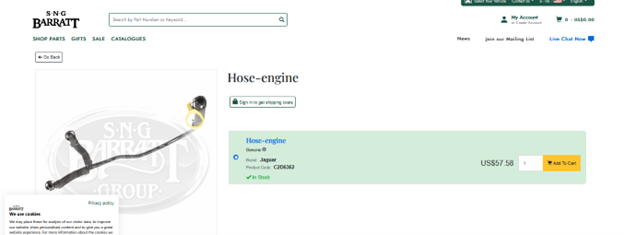

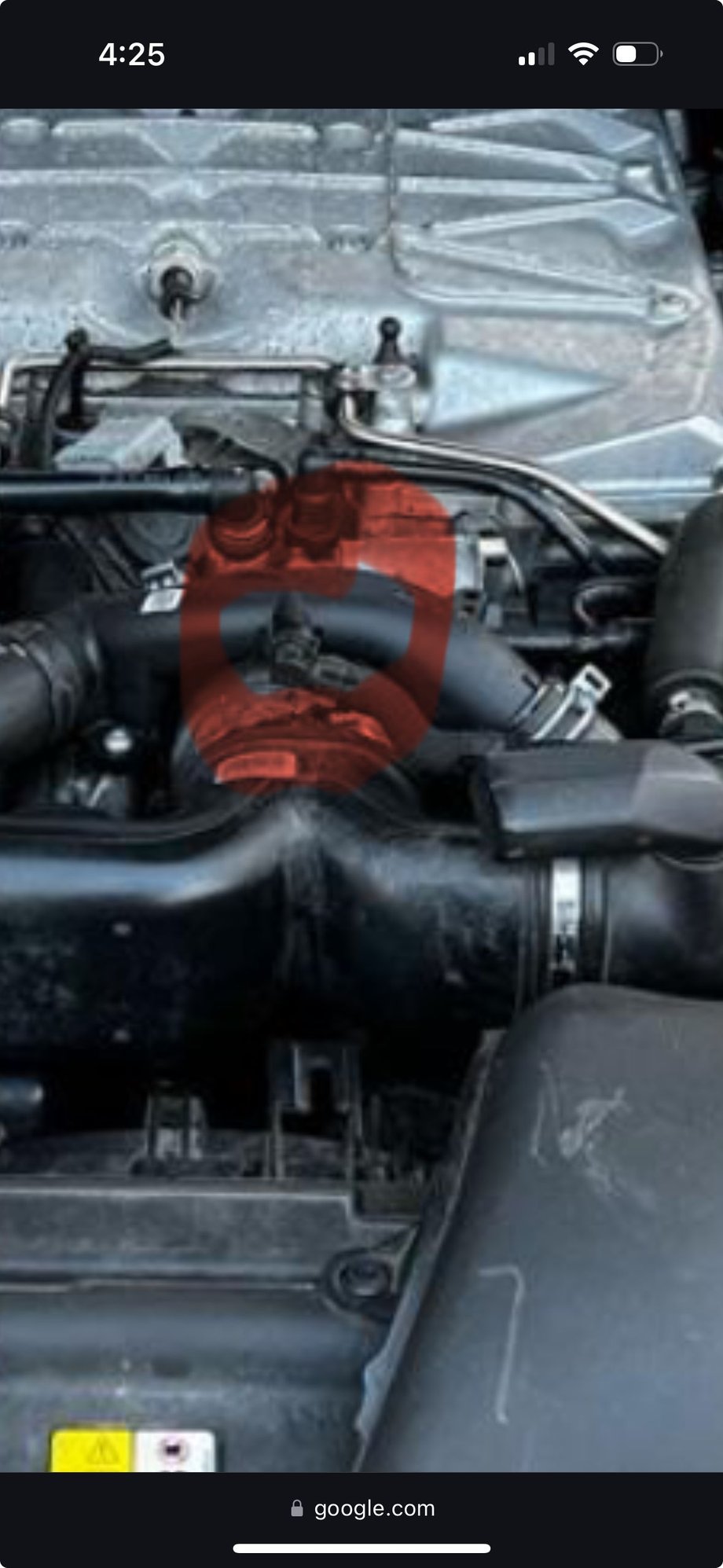

Also I broke the elbow for the line that goes to the reservoir. Dose anyone know where to find it? I’ve search the web with no luck.

Old Mar 16, 2025 | 05:01 PM
NBCat's Avatar
Posts: 6,068
Likes: 2,983
https://www.sngbarratt.com/English/#...20SYSTEM(12442)
