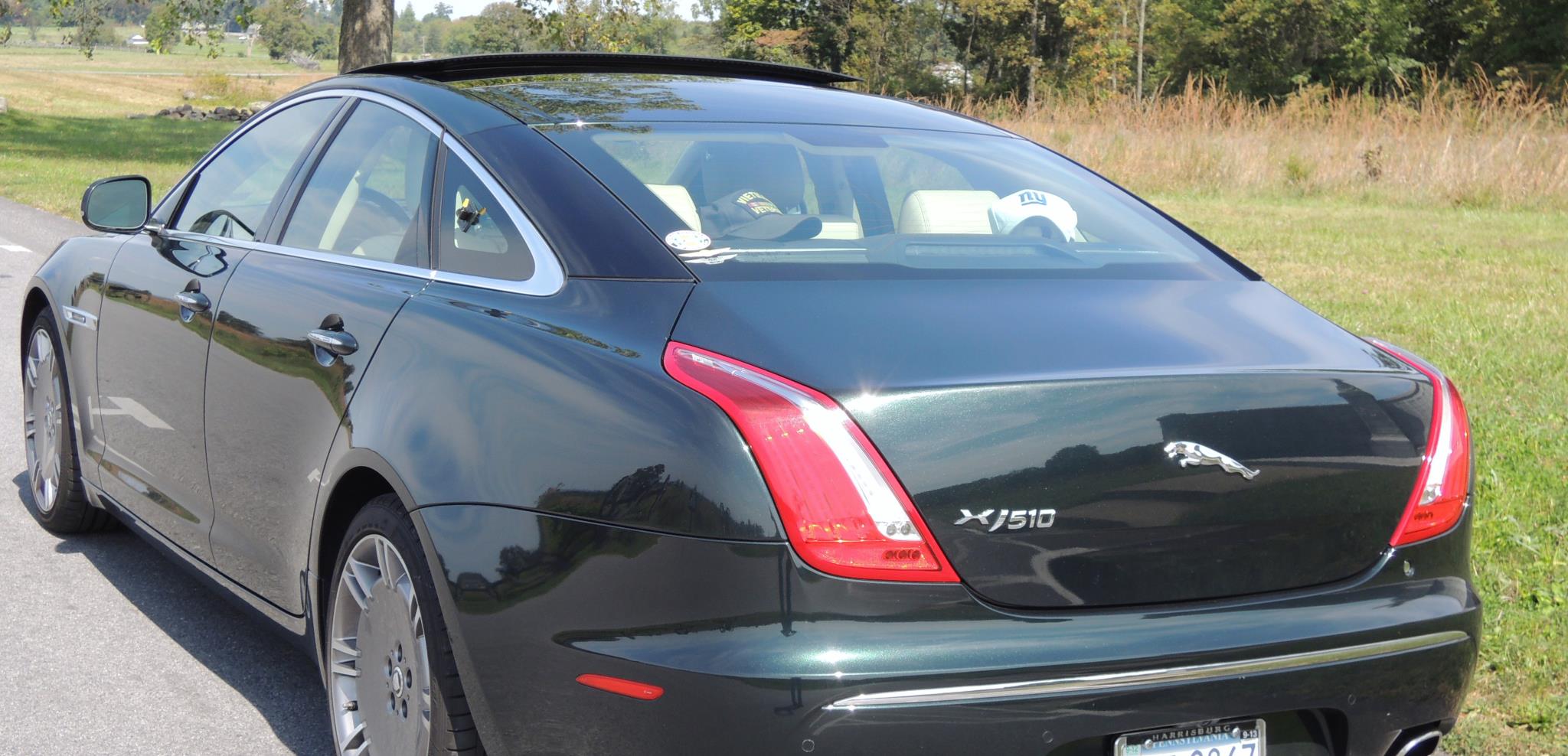

I have 2011XJ Super Sports 510hp.
I am looking to kick it up and need address
for a shop near Washington DC. or NYC
Right now the 510hp is amazing. With the right driver it will 0 to 60 under 4.0
Driving from Gettysburg Pa to Springfield Ill I hit 139mpr and it felt like 60.
With 35,000 miles this passed month, I am taking opportunities to push her a little.
