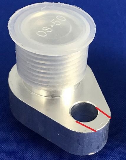

Yes and no. My old OEM hose did fit with some modification see my post #20 for better information.
What I neglected to document in that post is how I modified the peanut fitting. I cut the base so the hole is now a slot so it can self align. You need that because the position of the attachment stud has changed on the compressor.
I have the correct hose (Have not installed it since my modified OEM one is still holding pressure just fine) and it's the same part number so be aware that Jaguar made these changes but did not document any of it from what I can find. I was just caught out when the new style AC compressor arrived (Picture of the 2 compressors up thread in message #20.)
