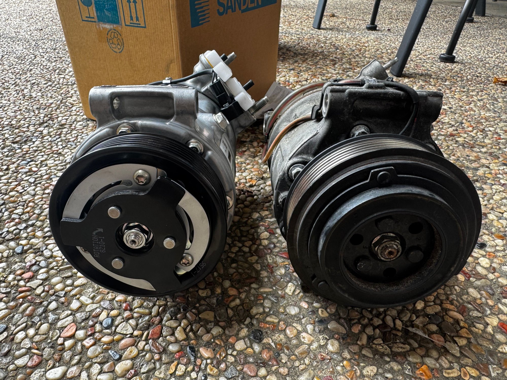

Updates: after 3.5 hours, I was able to get the factory ac compressor out. I found I had to remove the bumper entirely so I could have enough room to work from the drivers side wheel well.
Unfortunately, I am just now noticing that the compressor I got from that eBay link is a PXE16, while my factory unit is a PXC16. They look exactly the same except for a wire going to the pulley.
This is the unit that those eBay sellers recommended when I asked them last week. I’m waiting to hear back from them now.

Looking back at the link for the first one I ordered, I’m pretty that was the correct one after all, even though it said it didn’t fit my car. It looks exactly the same.

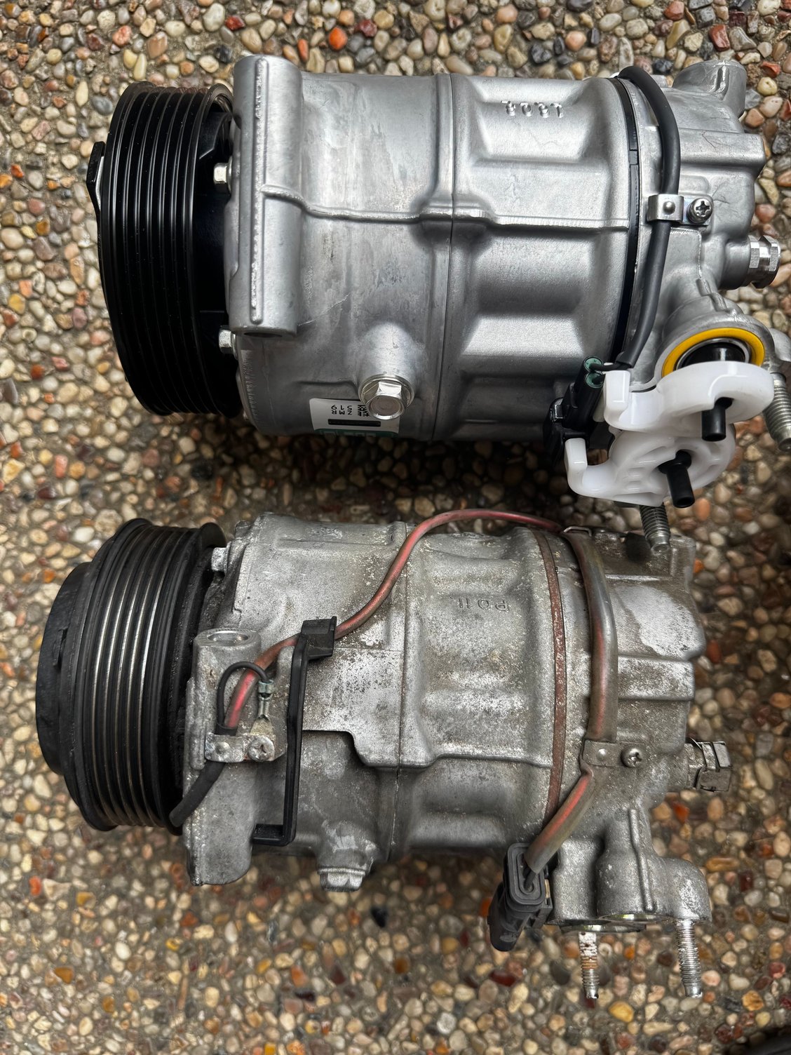

Yeah, the electrical connector is a different shape. This is definitely the wrong one. The one I ordered first was the correct one.

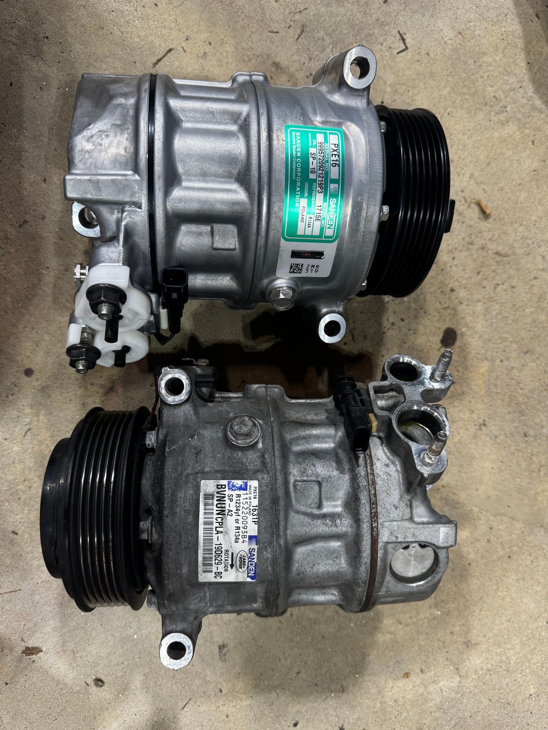

This is why we say you must look at the label on the compressor itself, ignore part numbers and online diagrams. JLR used multiple types of compressors throughout the range. The new compressor in that picture is a PXC16.

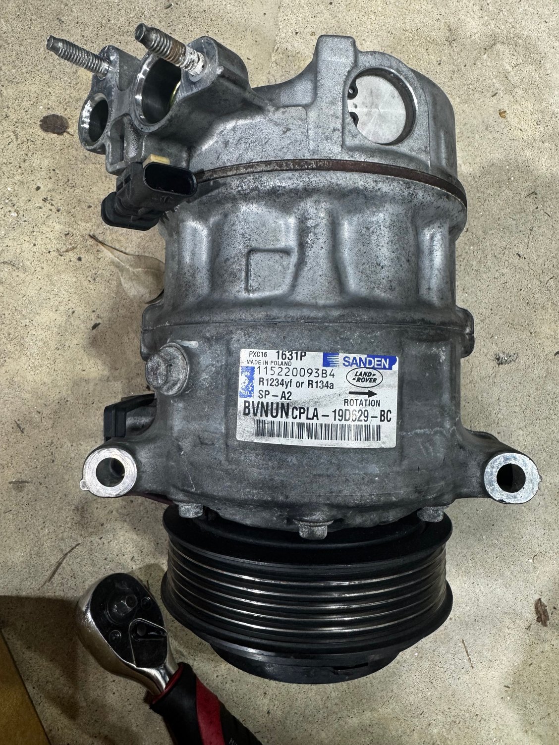

No, the new one is labelled PXE16. My old one is PXC16. I’ll take pics of the labels later today.
My blunder was trusting the so-called experts. I knew the oem unit was a PXC, and I still cancelled the original order and went with their recommendation.
The only problem I’m seeing with that original order is that the label on the unit says R1234yf whereas my old one says r134a. The oem unit label states it can take either one.

Yes that is one of the differences I ran into and mentioned in my upthread post.
The one with no wire no longer has a magnetic clutch on the front. It's all one solid piece now. If the compressor locks up that is a special shear pulley that shears internally allowing the pulley to turn independently of the compressor.
I think when that happens it's compressor replacement time. I have not seen anyway to repair the shear pulley setup.
Also note the yellow O-ring in one of your pictures. Your OEM compressor does not have that and neither did mine. But my replacement did along with the small differences in the peanut fitting stud placement.
