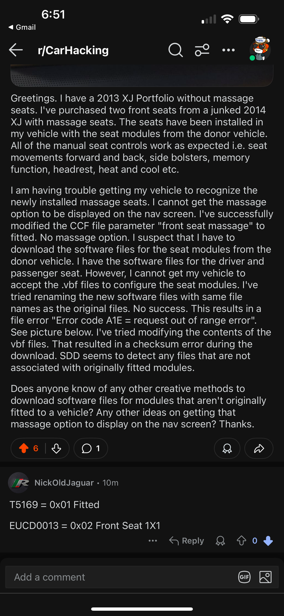

Greetings. I have a 2013 XJ Portfolio without massage seats. I’ve purchased two front seats from a junked 2014 XJ with massage seats. The seats have been installed in my vehicle with the seat modules from the donor vehicle. All of the manual seat controls work as expected i.e. seat movements forward and back, side bolsters, memory function, headrest, heat and cool etc.
I am having trouble getting my vehicle to recognize the newly installed massage seats. I cannot get the massage option to be displayed on the nav screen. I’ve successfully modified the CCF file parameter “front seat massage” to fitted. No massage option. I suspect that I have to download the software files for the seat modules from the donor vehicle. I have the software files for the driver and passenger seat. However, I cannot get my vehicle to accept the .vbf files to configure the seat modules. I’ve tried renaming the new software files with same file names as the original files. No success. This results in a file error “Error code A1E = request out of range error”. See picture below. I’ve tried modifying the contents of the vbf files. That resulted in a checksum error during the download. SDD seems to detect any files that are not associated with originally fitted modules. Does anyone know of any other creative methods to download software files for modules that aren’t originally fitted to a vehicle? Any other ideas on getting that massage option to display on the nav screen? Thanks.

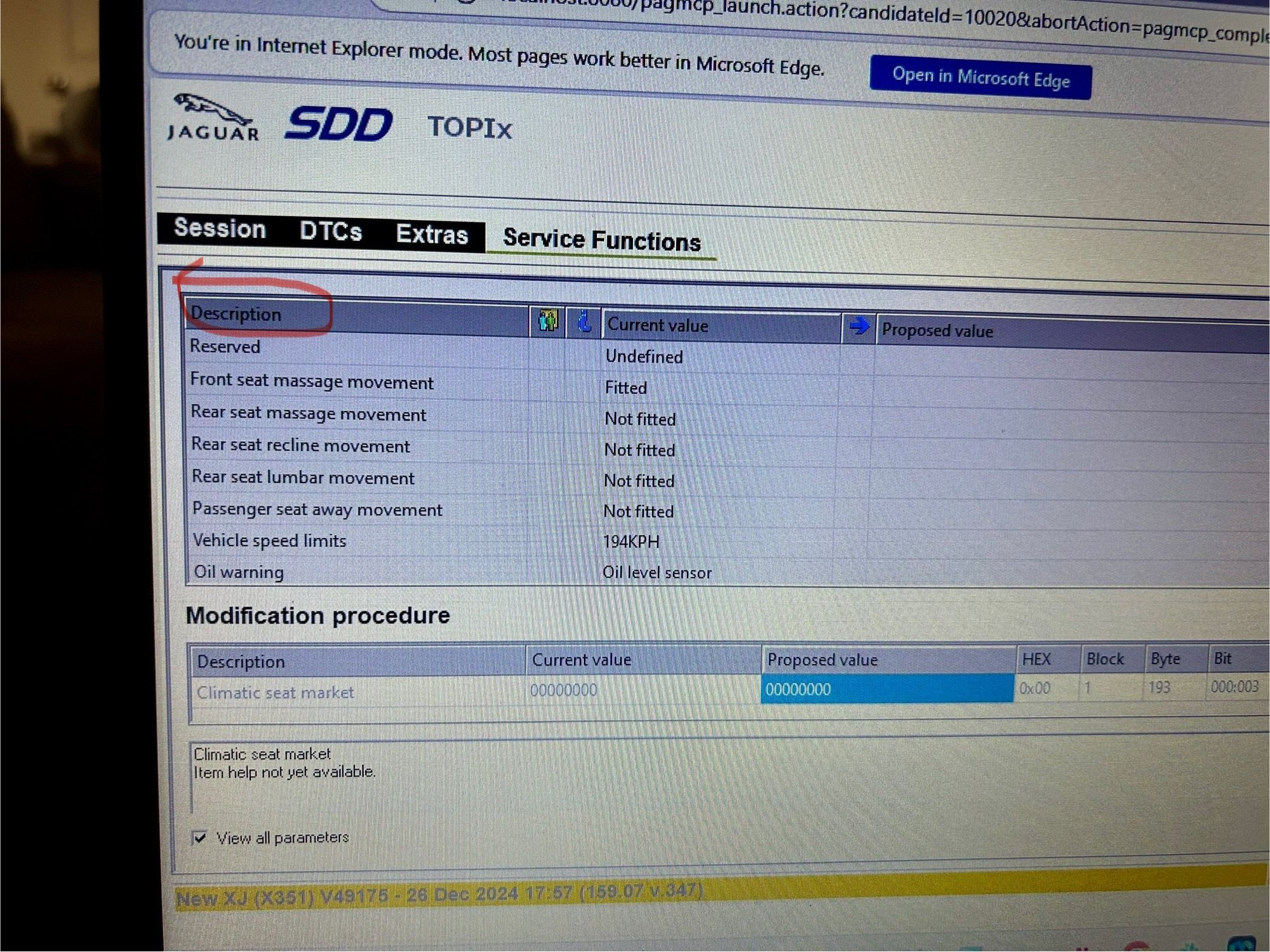

I’m having difficulty finding a password to get into engineering mode at the moment. I was using the website Vehcom.com to get a seed code. I’ve used this site for years. For some reason, my account is now limited. I have to find another way to get a seed code. Anyone know of another site that generates seed code passwords?

Is there a way to get the name of those 2 CCF parameters from NickOldJaguar? What name are they under in the list of “ descriptions”?
The CCF descriptions that are pertaining to seats that I can see are:
Heated Seats
Cloth/leather seats
Seats
Memory Seat Movement
Front Seat Massage Movement
Rear Seat Massage Movement
Rear heated seats
Rear climatic Seat (heated and cooled)
Driver’s seat type
passenger seat type
climatic seat market
Number of climatic system zones
Seat track position sensor fitment
Heated rear seat
seat heat calibration
heated front seats
front seat ventilation
seat track sensors
seats
What is the name of those 2 parameters that need to be changed?
What is the description name of those 2 parameters that need to be changed?

hello so I managed to get his response for your question. This is what he said,
“Sorry, not using sdd anymore, so can't tell you how these called in sdd and about a passwords.
The first parameter - you've already modified it. The EUCD0013 one is not even listed in SDD's xml files (however is present in a ccf itself) so you need either to decrtypt/modify/encrypt back the .exml files of sdd or use some other ccf editor to modify a CCF.vbf file itself and then load it with sdd.”

I didn’t get an attempt at modifying the CFF file. You can’t make modifications to the CCF with modules that aren’t originally fitted to the vehicle on the car. The CFF options will be grayed out, and not changeable. I spent all yesterday removing modules in effort to avoid SDD detecting them. I have replaced a lot of components on my vehicle. The infotainment screen, added rear seat entertainment screens, entertainment module, headlights, seats, rear screen shades, overhead consoles, gear shift, seat switches, newer satellite radio module etc. It appears that SDD keeps detecting a component. After I put my car back together, I thought about the internal massage bladders in the seats that I added. I never actually disconnected the seats from the seat modules. It’s possible that SDD is detecting them.
I’m gonna take a knee on this for now. I’m going to buy another diagnostic tool that will hopefully allow me to modify the car’s configuration file despite having modules that are not associated with my car’s vin.
