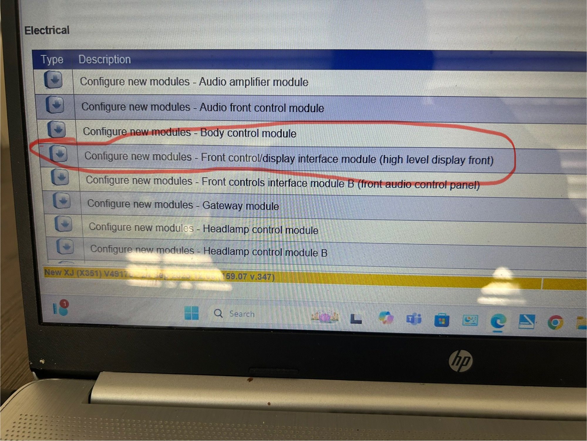

I did not try that. What do you mean? Do you mean configuring the High Level Front Display module in SDD?
Old Sep 24, 2025 | 02:48 PM
  #35
JoshMcMadMac's Avatar
Joined: May 2023
Posts: 132
Likes: 24
From: USA
No, never "configure new" unless you have a new module (or you are 100% certain you know what you're doing). That can brick the module.
You want to go down on the Extras page to “InControl – learn vehicle variant” and run that.
