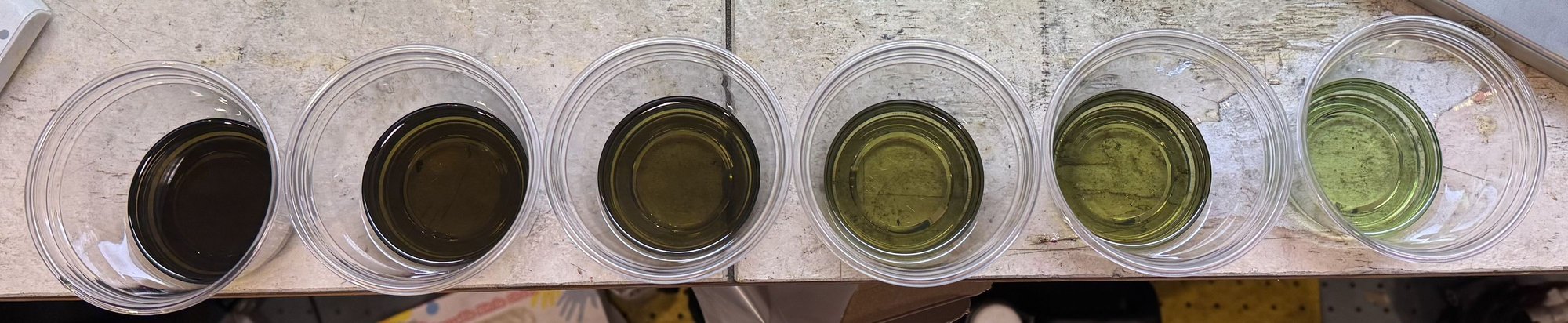

Just did the fluid change on my 2019 XJL. It took 12.5L in total to bleed out all the old fluid by removing the transmission fluid hose from the transmission cooler and running a rubber hose into a catch container.
When I dropped the pan, I got out about 4 liters out. So that means there's more than half of the dirty old fluid still in the transmission. It doesn't make sense to do multiple fluid changes when you can simply bleed out all of the old fluid by removing the transmission cooler line and start to car to bleed out 1 liter at a time. Then, refill that liter through the fill plug and do it again until you get all the old stuff out. It takes about 7 seconds of the engine running for 1 liter to come out, which safely makes sure you won't run the transmission dry.
I removed the transmission line closest to the firewall on the trans cooler because it's the easier one to reach from underneath the car and it flushes out the old fluid in the trans cooler as well.
Here is a pic showing how dirty the fluid was after only 5 years/27K miles. The far right is pure fluid straight from the bottle for comparison. Keep in mind that's only 27K miles of easy driving and the fluid is already that black. Jaguar says the fluid is for life, ZF says it about every 60K miles, but the independent company in the UK that is famous for being the specialist for rebuilding failed ZF transmissions recommends every 30K miles. So I am going to go with 30K miles or less.
My car is shifting just as before as before the change and is good to go for years since I don't do a lot of miles.
Definitely don't do the multiple drain and fill procedure. The multiple drain and fill is just a lot of work to keep a lot of dirty fluid in the transmission.

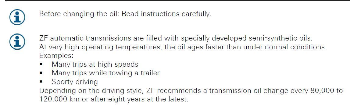

Again it pays to go right to the source instead of listening to "Armchair Experts" with decades of out of date experience.
Your kidding right?? "Changing to new frightens the computer, and the increased solvents in the new fluid rinse all the particulate debris in the unit"
Can you explain how I am to frighten a computer?
Here is what ZF has to say about fluid changes. And as posted above you simply CAN NOT change the transmission oil too often or too soon!
The document where this came from is attached.
That's pretty black and white from the company that designed and manufactured the transmission.
For us dumb Americans that's 50K-75K miles.
