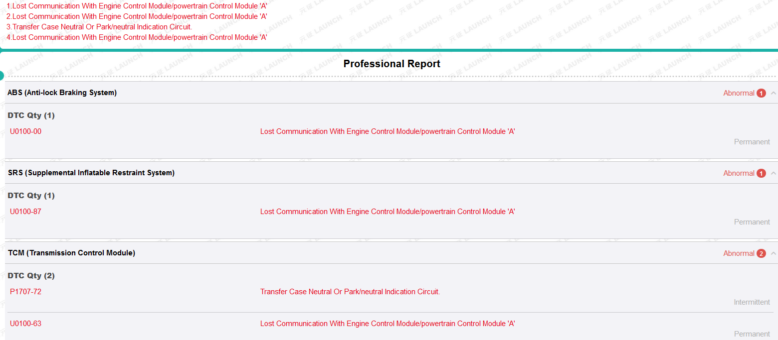

Old Jun 1, 2023 | 07:50 AM
Martez78's Avatar
Joined: Jun 2020
Posts: 16
From: Columbus Ohio
Looks like this is the result

The fusebox input are only to power vehicle enough to have pover for trunk opening, nothing else. Not even turn the ignition on. There are not thick enough wires to cope more. The AAA fellows should know to check markings on the lids of power inputs.
I donīt know what will fail in this case, there are several cases known, even in this forum, but the owners have not been reported what or how they got vehicle running again?
