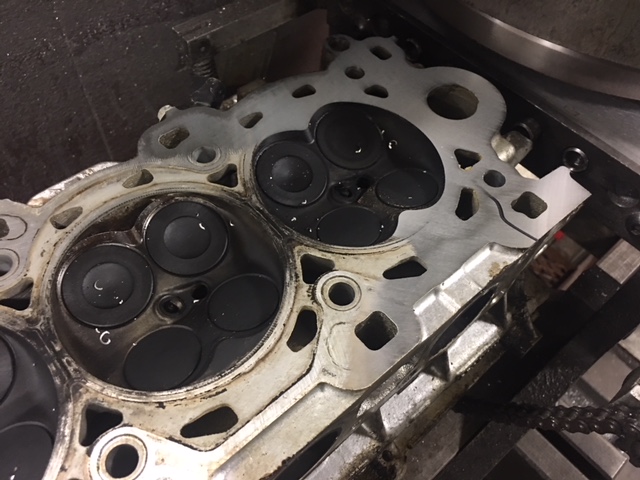

well it was a success on the machining of the block deck. ordered head shim.

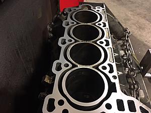

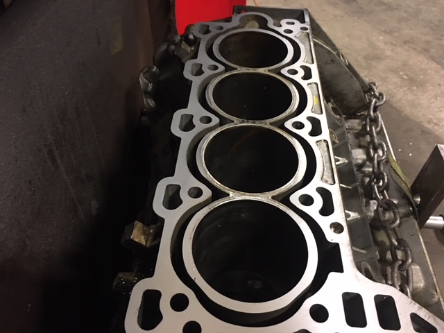

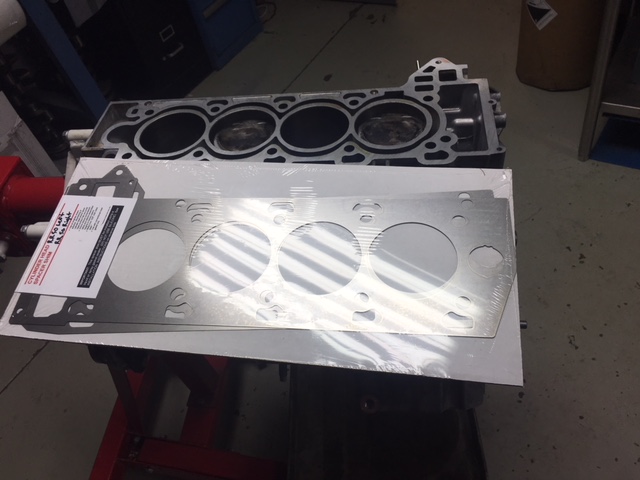

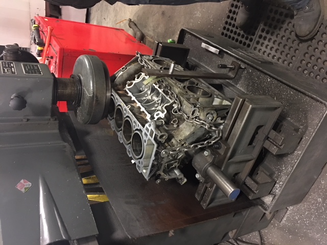

what can I say I love it when someone says it cant be done, and maybe it cant, but I love the challenge. first off I was extremely lucky with the internals with this engine.
I knew about the parts being hard or not available. I did an extensive checking of the internals before committing. brgs,pistons,rings all in perfect order. I feel totally confident on
reusing what I cant get. here's where I'm at.
Attached Thumbnails Block warped-img_2494.jpg   Block warped-img_2495.jpg   Block warped-img_2496.jpg   Block warped-img_2508.jpg

Really nice work!! How much did you have to shave the block and head surfaces?
