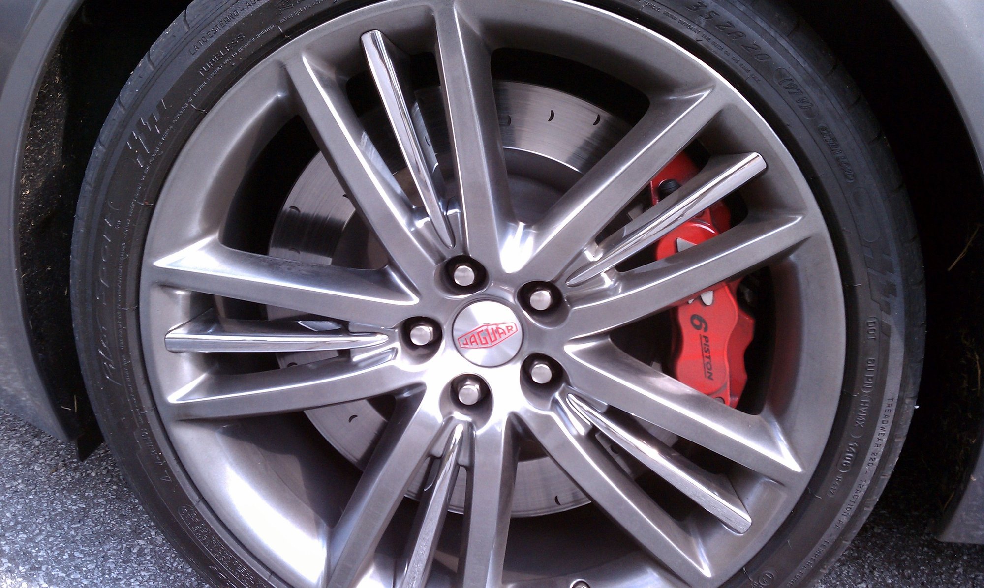

Another possibility is a caliper with a sticking piston. This can cause a lot of vibration. I've experienced this myself.
How many pistons do the X351 front calipers have?

I think they have 3 pistons, but I might be mistaken.
I am a patient driver. I rarely turn the engine to 3-4k rpm or hard brake it.
3 pistons is impossible. They are either 1,2, or 4. Maybe 6 or 8 is possible, but never heard of it.

Jaguar 6-piston front caliper on my 2009 XKR.
