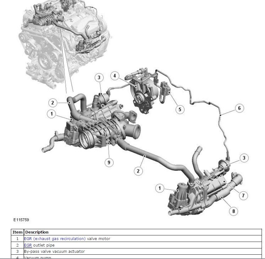

Is the part visible anywhere on the diagram below? Or is it not the right one? It was sort of curved in the middle where it broke.

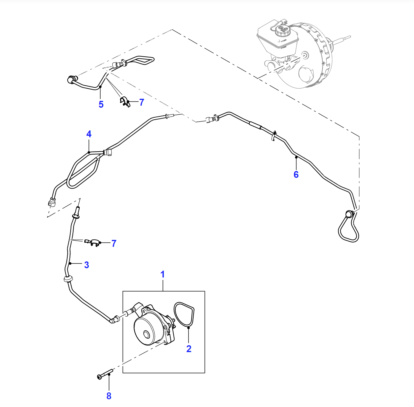

Hi, I think that pic are from gasoline engine? On V6 diesel the vacuum pump is in the end of camshaft.
How about the pipe nr.6 from this picture?
EDIT: this is not correct, check my next post.

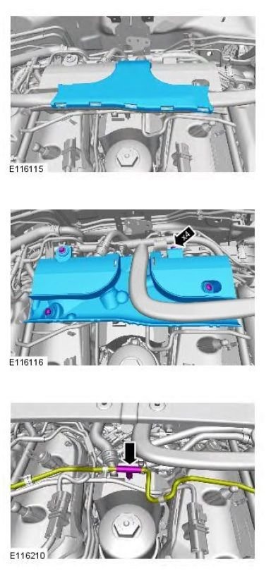

Nope, correction, my bad.
It´s seems to be crankcase breathing hose. Connects both camcovers to the oil separator in midlle of engine.
Check this:

I try to search it from repair manual, but no part numbers mentioned. Found this description for it in one table: "Cylinder ventilation scavenger hose (2 off)".
Propably should be: Crankcase ventilation....
This pipe have quite low vacuum, and it dosent effect runnig if it´s leaking or not, so i would just repar it with some rubber vacuum hose.
