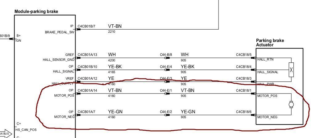

Ok, so some researching indicates that all that may need to be done is manually probe (or apply power) to the motor, pos. and neg. Seems older model XJs (and others) had different color wires, red/white and green/white. On the x351, it looks as though it may be Violent/Brown and Yellow/Green. Does that look right here?
