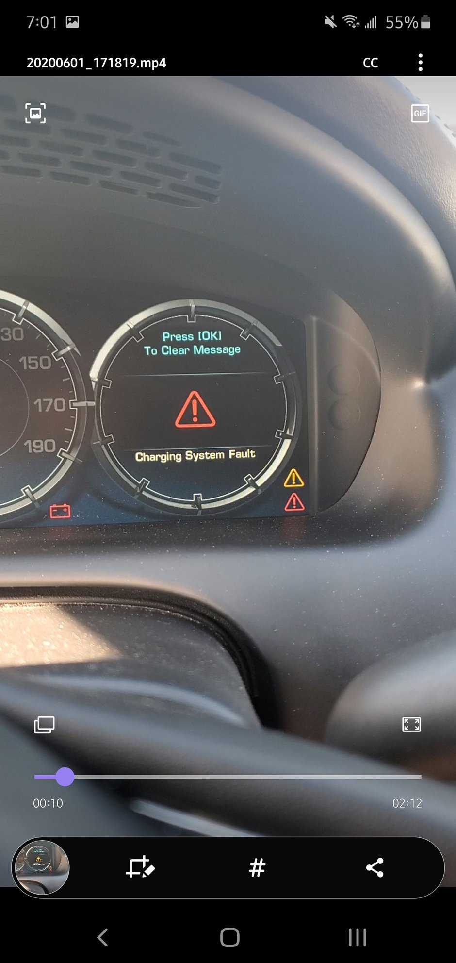

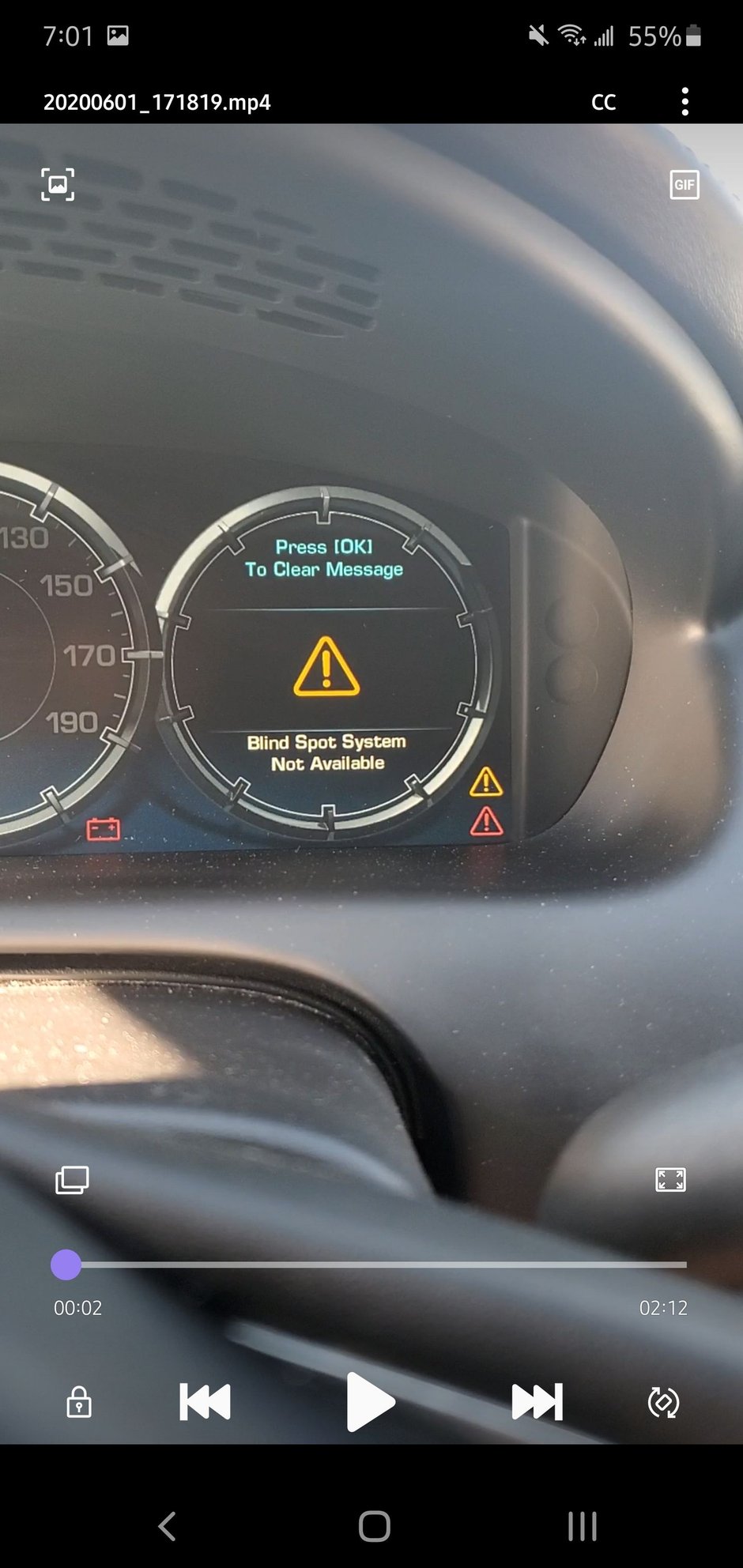

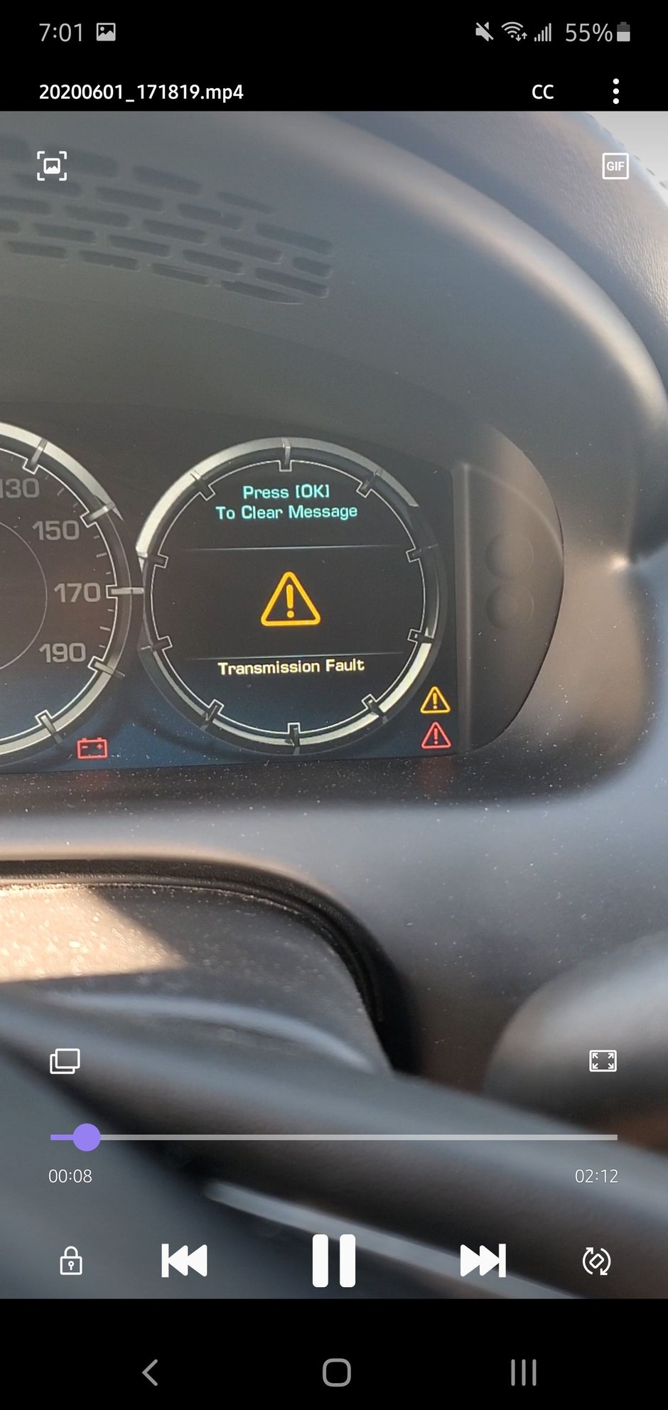

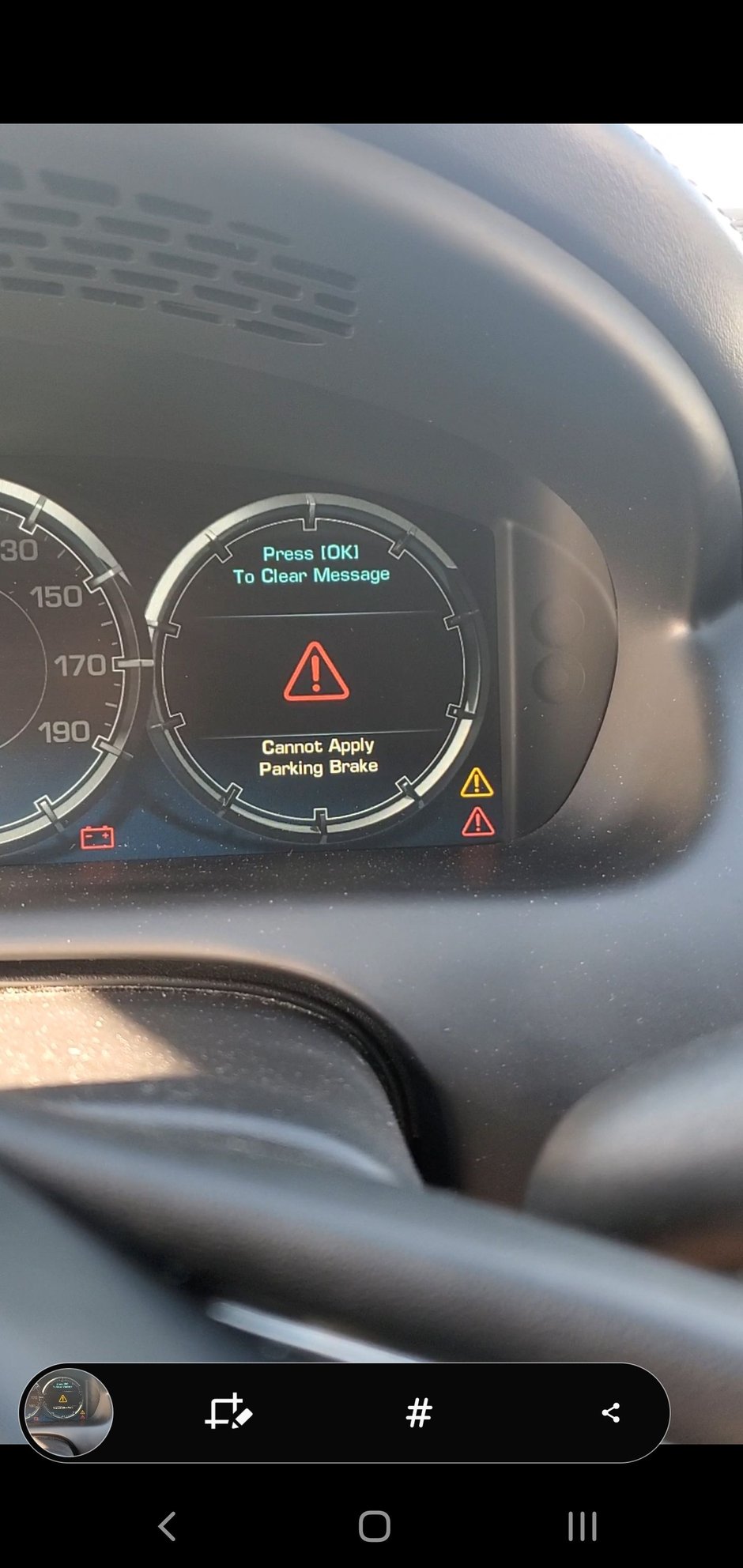

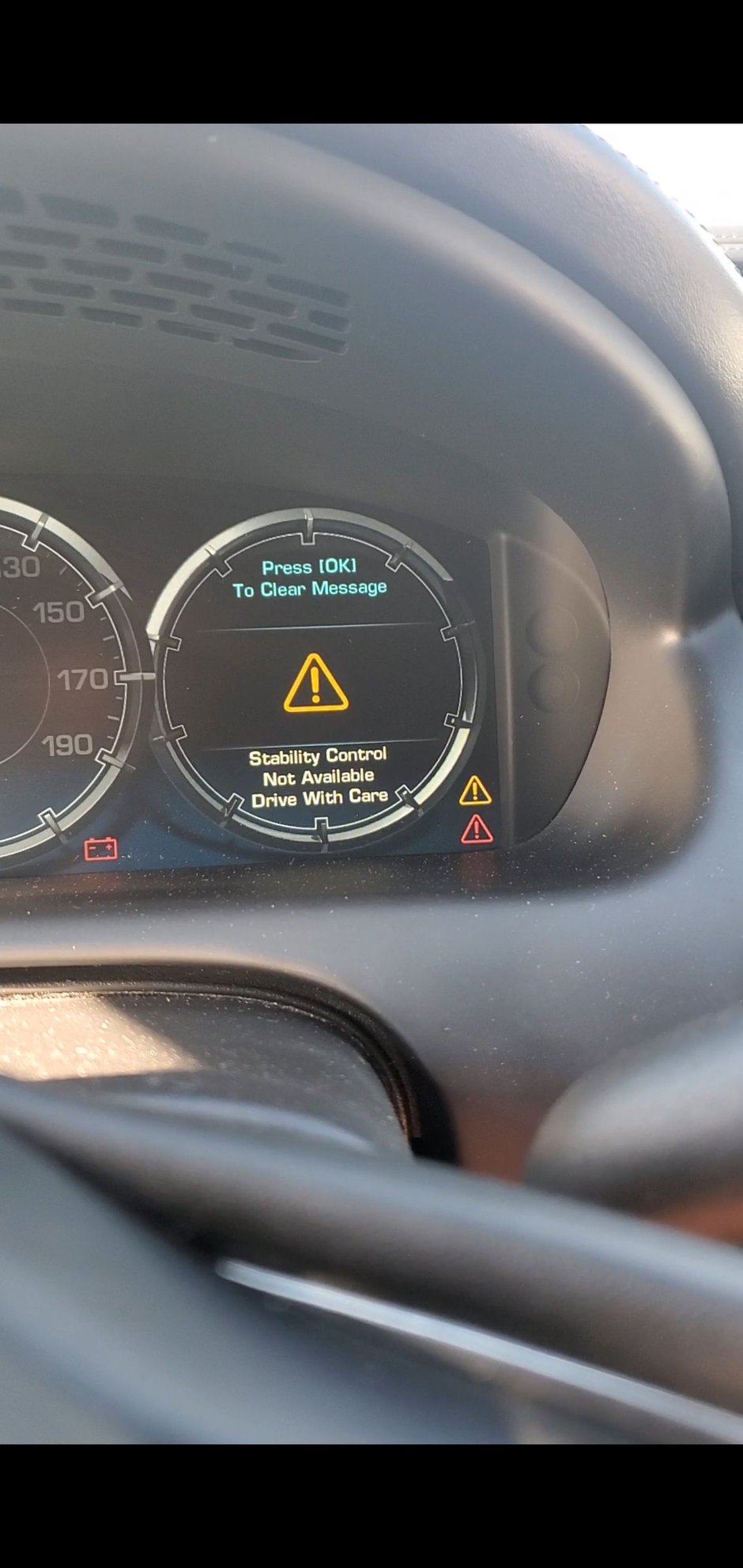

with engine fully assembled and fixed i go press the start button, and dash lights with bunch of errors (pictures above), then i press brake to start engine, and i nothing, the dash turns off and starter NOT even clicking.
i put scanner (cheap one is only i have) and i get only one code U0100 lost communication with ECM/ PCM.

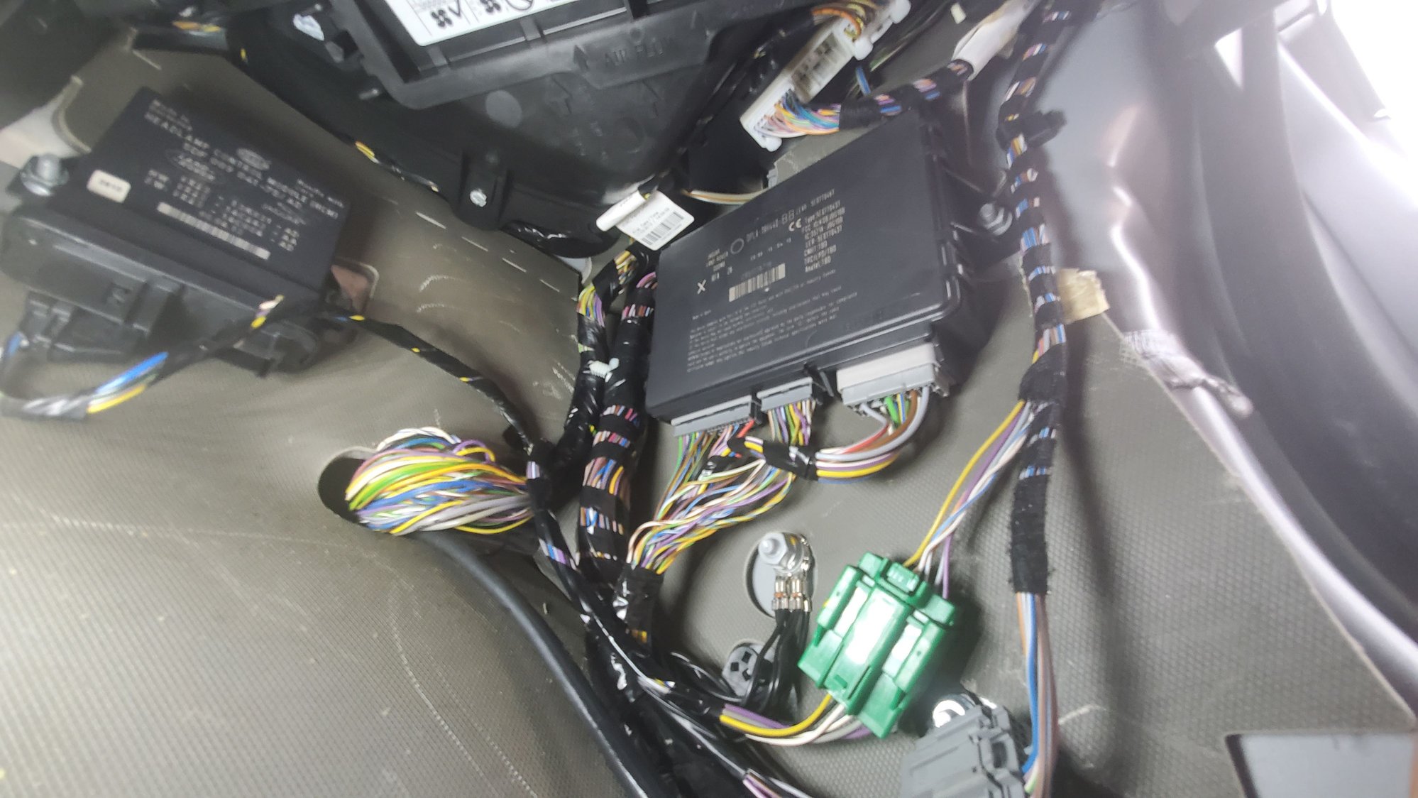

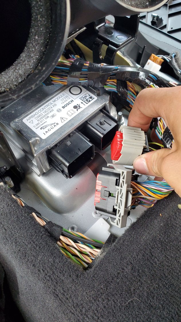

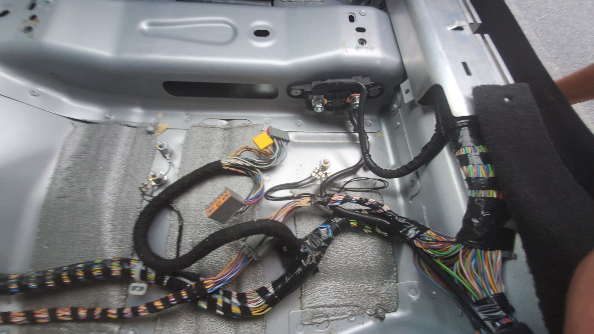

so i followed that link, anf it takes to to the airbag control module, it's directly unde the rear seats climate control.
how can i check it? i need to buy another one or needs reset from dealer?
A dealer can reset it, but so can you merely by pressing a button on the switch once you've found it. AFAIK its nothing to do with the airbag module, and is found inside the panel in front of the driver door, but I may be wrong. The inertia switch cuts off power to the engine, fuel pump, controls when its tripped by sudden deceleration, like in an accident. Of course your car model may not have one, its the model after the one I had.

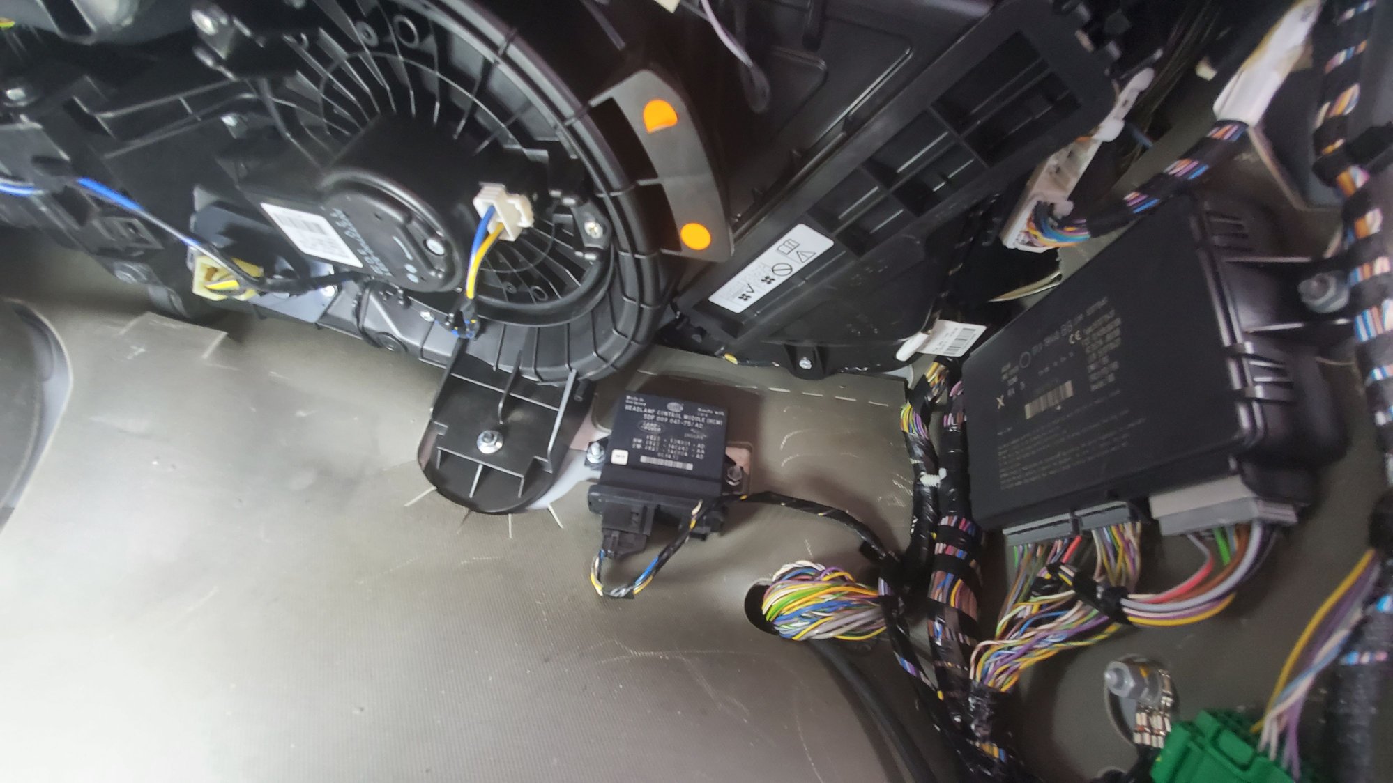

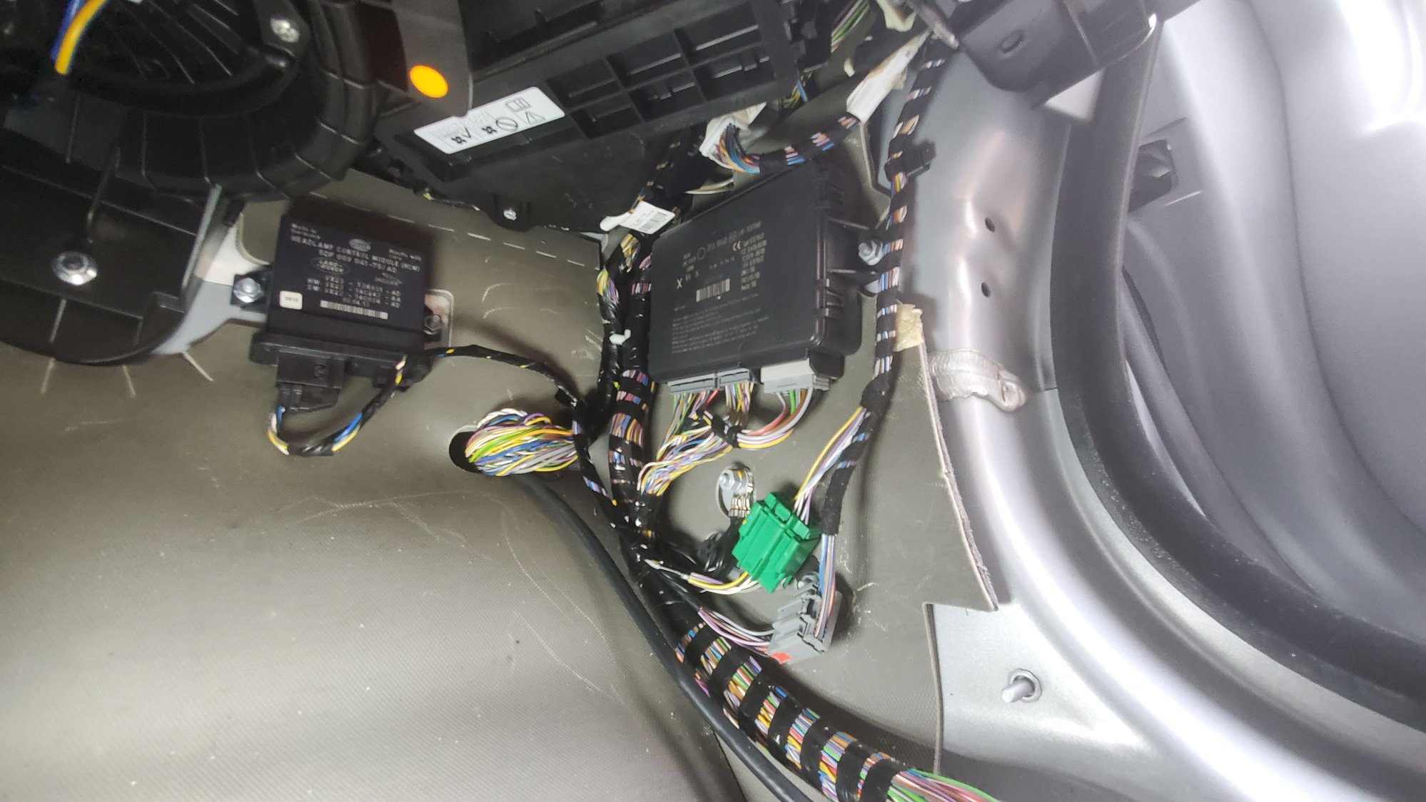

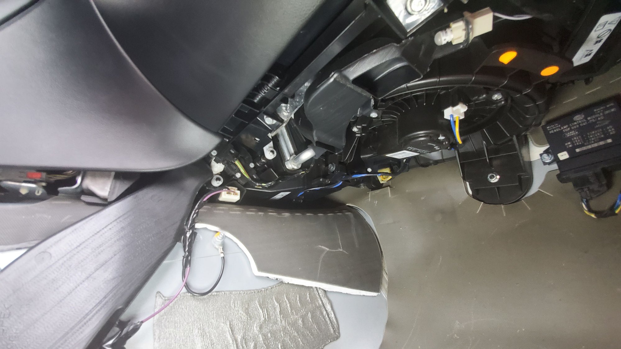

first is the airbag control under rear climate control, the others are passenger foot area
