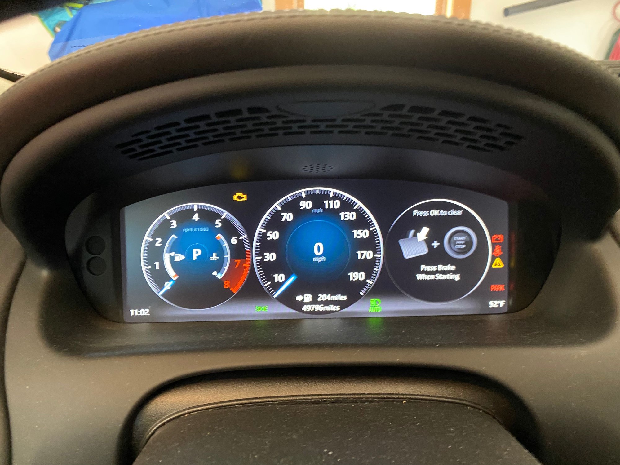

I own a 2016 jaguar XJL portfolio AWD.
yesterday driving home I decided to use the paddle shifters for the first time in almost 2 years.
I had the car in S mode when doing so.
when I got home I turned off the car but must not have shifted it into park. Not really sure to be honest.
this morning when I tried to start the car the lights on the radio and dashboard would come on but the car would not start and the shift knob would not come up.
A sign came on the dashboard saying @press brake when startin. Which of course I did.
The note also said press “OK to clear”. Not really sure what that means.
It doesn’t seem to be a battery issue as the lights come on and the hood is able to open etc.
any thoughts or suggestions as to what to do? ??

Thanks for the reply Vasara. I put my foot firmly on the break and held it down for well over 10 seconds while pushing the start button.
Still no luck
I find it quite unusual that I’ve had the car for well over two years and the only time this has ever happened is immediately after I used the shifting pedals on the back of the steering wheel.
Maybe I didn’t do something right when I was using them?

I think u may be on to thing regarding that failed brake pedal switch suggestion. The brake pedal is very very firm when I step on it
to start the car. More so than usual.
And of course the gear switch will not pop up unless the car is started. So logic would say that it’s not necessarily a gear switch issue yet at this point?
The car is at home in my garage and I am at the office. I will have my wife test it and find out if the brake light goes on.
I am assuming I will have to have the car flat bedded to the local jaguar dealership.
Hope that is the only issue with it.
You mentioned it may be cheap and easy to change. Any dollar estimate on that?
Thanks and much appreciated!!

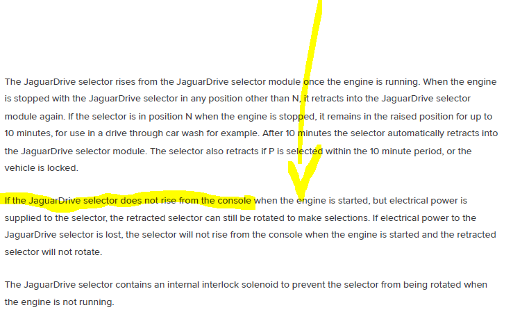

And back to the original description of the problem, I could swear that I've seen somewhere (like the owner's manual or possibly Topix literature) that gave instructions in the event that the shifter knob fails to raise - just can't recall where that was.

... I could swear that I've seen somewhere (like the owner's manual or possibly Topix literature) that gave instructions in the event that the shifter knob fails to raise - just can't recall where that was.[/QUOTE]
Found it - to quote from the Topix Drivetrain section titled:
"AUTOMATIC TRANSMISSION/TRANSAXLE EXTERNAL CONTROLS"
"EXTERNAL CONTROLS - SYSTEM OPERATION AND COMPONENT DESCRIPTION"
under the "ROCKING FUNCTION" paragraphs (although it does say when it's running):
Old Apr 19, 2023 | 08:55 PM

Hey thanks for that update!
And you are correct, it does say how to fix the gearshift rising issue “when the engine is running”.
Unfortunately my engine isn’t running
