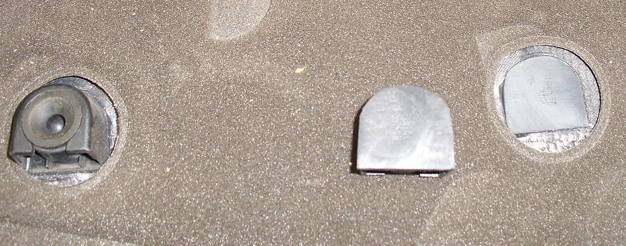

Changing oil and found the engine cover loose. One of the rubber grommet holders sheared off the bottom of the CF cover very cleanly! Lucky the rubber part kept it on the metal mounting pin. Just have not seen or read about it before either?
I did some searching and the rubber grommet is not available from Jaguar but there is a BMW part a forum member found that did work. BMW-13717588501. Also had a JLR C2Z25071 mentioned but no one had tried them to see if they fit other Jaguar models.

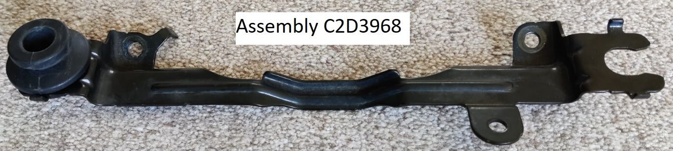

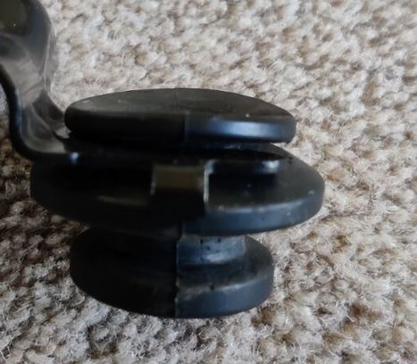

Next the rear of the cover was also loose and somehow one of the rubber biscuit's was missing. Of course JLR does not offer just the rubber part. The entire bracket is C2D3968 and it's only about $35. Not sure it comes with the rubber parts but I think it does.
The rubber I am looking for is mounted on the end of the bracket.
Does anyone by chance have a part number for just the rubber part?
I have found a couple of used brackets on EBay if it comes to that.
