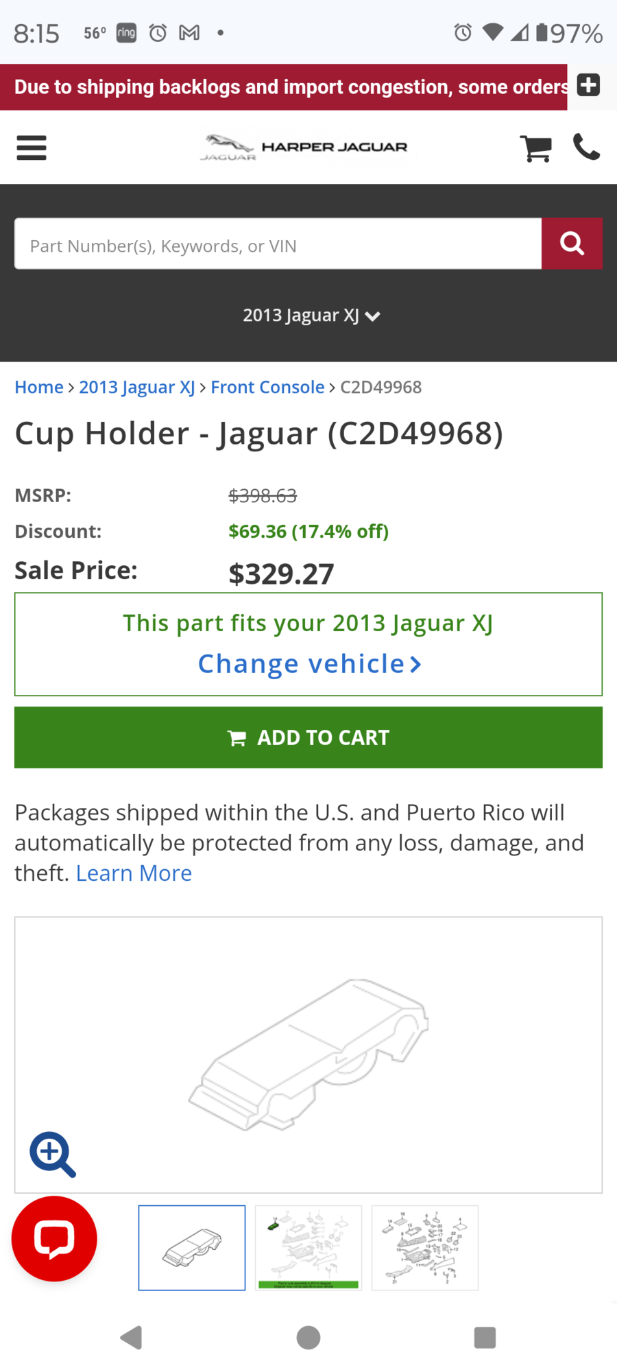

I have read many threads about fixing or repairing the sliding cup holder lid on the x351. In some, a revised and improved version is mentioned but never a part number. I have checked ebay and the ones for sale are noted with a part number c2d49968, so I’m assuming that is the original part number. Does anyone know the part number of the new and improved version. You guys are great, thanks much in advance.

Click on the link in Post #3, above, for details and photos of how I replaced mine using Jaguar Part # C2D49968. That is the improved version.

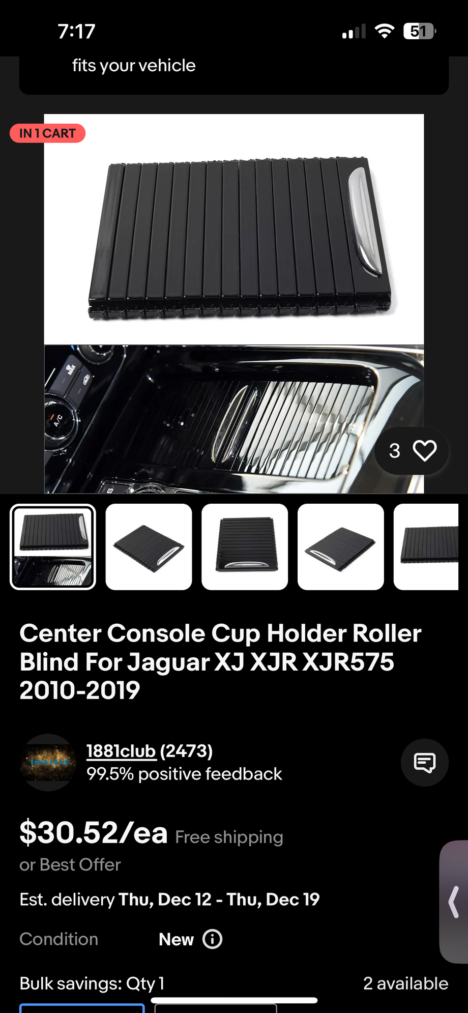

Please do not buy a brand new cup holder assembly from Jaguar. My cup holder lids were functioning just fine, however, they were scuffed. I purchased two of these sliding lids from eBay for a fraction of the cost. They fit into cup holder assembly, no problem. My cup holders look brand new again. Hope this helps!
