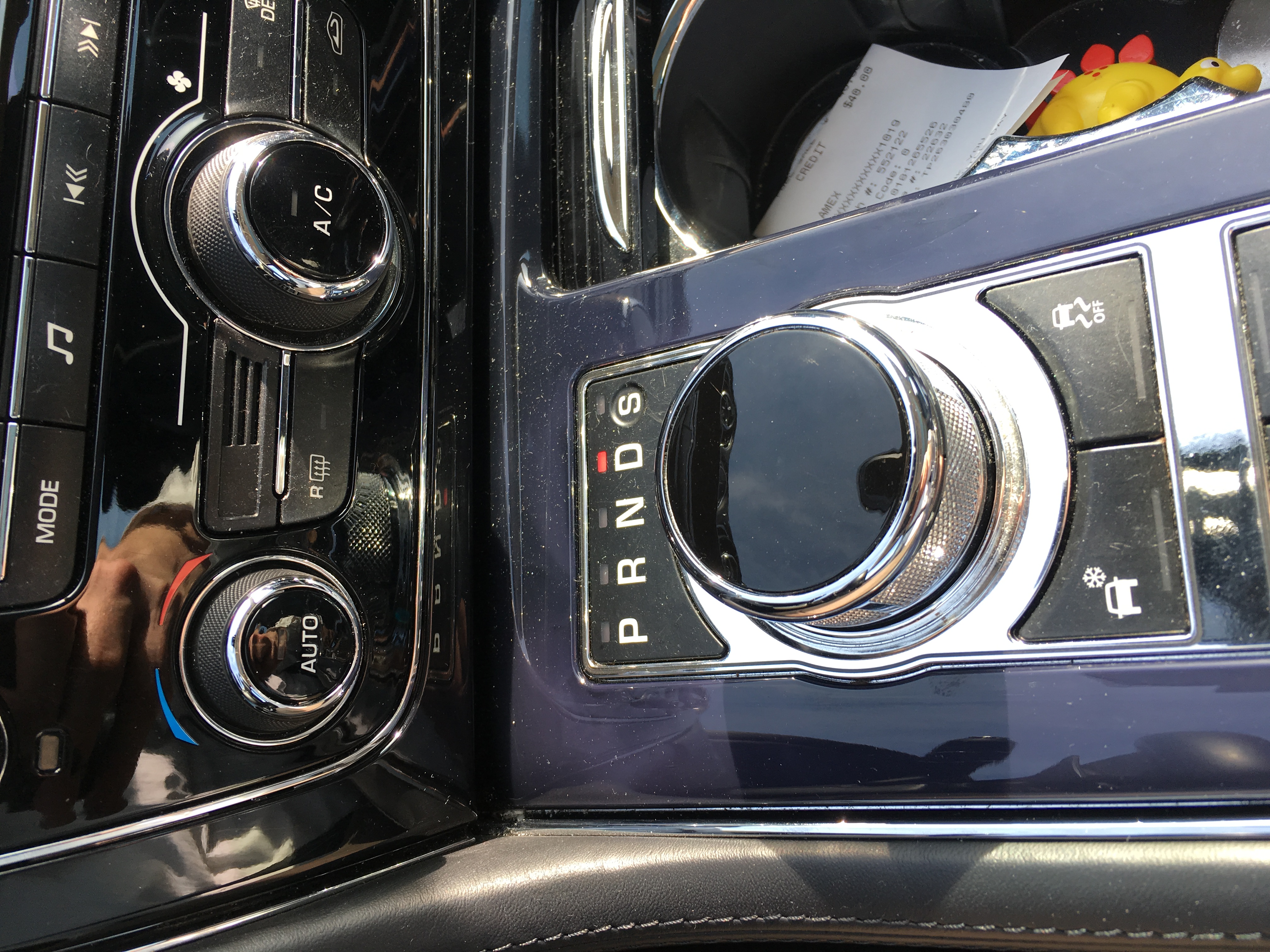

I can't believe I've had my car for so long and haven't noticed this before. I was cleaning the interior yesterday and noticed that the black trim that surrounds the radio/HVAC controls and the trim surrounding the shift knob/cup holder area aren't the same color. The radio trim is black and the shifter trim is blue. I called the dealer and inquired on it and he said that since it's a Supercharged model the console trim will always be a different color. Doesn't seem to make too much sense, and it seems like every other picture I've seen show matching black trim. Doesn't bother me too much, just wondering if anyone else has blue trim around the shifter and cup holders or if it's just me. I took a picture so you can see what I mean.

Mine is black and, for that matter, I've never seen, another color on the console or radio/HVAC surround in an X351

I believe that your dealer's explanation is BS. My 2013 XJ 5.0L is supercharged and all the wood trim in the center (upper and lower) is piano black. One way to know for sure is to call your dealer's parts department for the price of the shifter trim and ask if it's available in any color other than piano black.
All I can think of is that the piano black finish on your horizontal shifter trim faded due to exposure to direct sunlight, but the vertical piano black panel surrounding the radio/HVAC controls didn't fade because it didn't have direct sun beating down on it. My piano black trim is still like new, but I always use a reflective sunshade when parked outdoors and have custom tinted windows to protect the interior.

+2.
Your dealer is giving you a made up answer to make you go away.
There is only one gearshift surround part all the way up to VIN53137: C2D24841. C2D6306, C2D16524 and C2D18191 are all interchangable parts with minor engineering changes.
The centre console (floor console) is slightly different for supercharged vs non-supercharged vehicles, but not that trim piece.
It costs about £150 in the UK, but car breakers will have them for much less. Yours looks to have been taken care off (no scratches in the finish) so be careful choosing a used replacement if you go down that route as many are scratched by keys, rings, etc.
Yours appears to have faded in the sun. If you pop it off (it just clips on from above) check the far edge that sits flush with the AC control panel to see if that has faded as much. It looks like it hasn't form the photo, but it is in direct sunlight so hard to tell.

It's funny this comes up now...I just noticed my piano black trim was starting to look sort of bluish in direct sunlight.

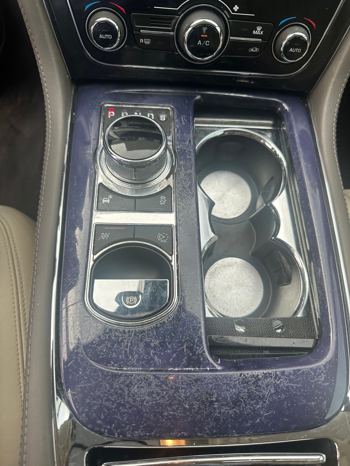

Have not gotten an explanation, but mine is blueish/purple in color!
Yours isn't just turning blue, but your whole console is beat to crap. There was a video somewhere on fixing the cup holder covers. And if I were you, I would follow the recommendation above to remove and wrap the trim in gloss vinyl.
Old May 13, 2024 | 08:47 AM
rothwell's Avatar
Joined: Jan 2009
Posts: 2,199
Likes: 1,371
From: Hudson, Florida
How to wrap the blue part is covered here in my working thread.
That blue bezel has enough scars that it may need to be sanded before vinyl can be applied smoothly. I see a crack that would need attention too before wrapping.

Your sliding cupholder cover is in bad shape and can't be repaired. Ask me how I know.
Here's what to do:
DIY Cupholder Sliding Cover Replacement
