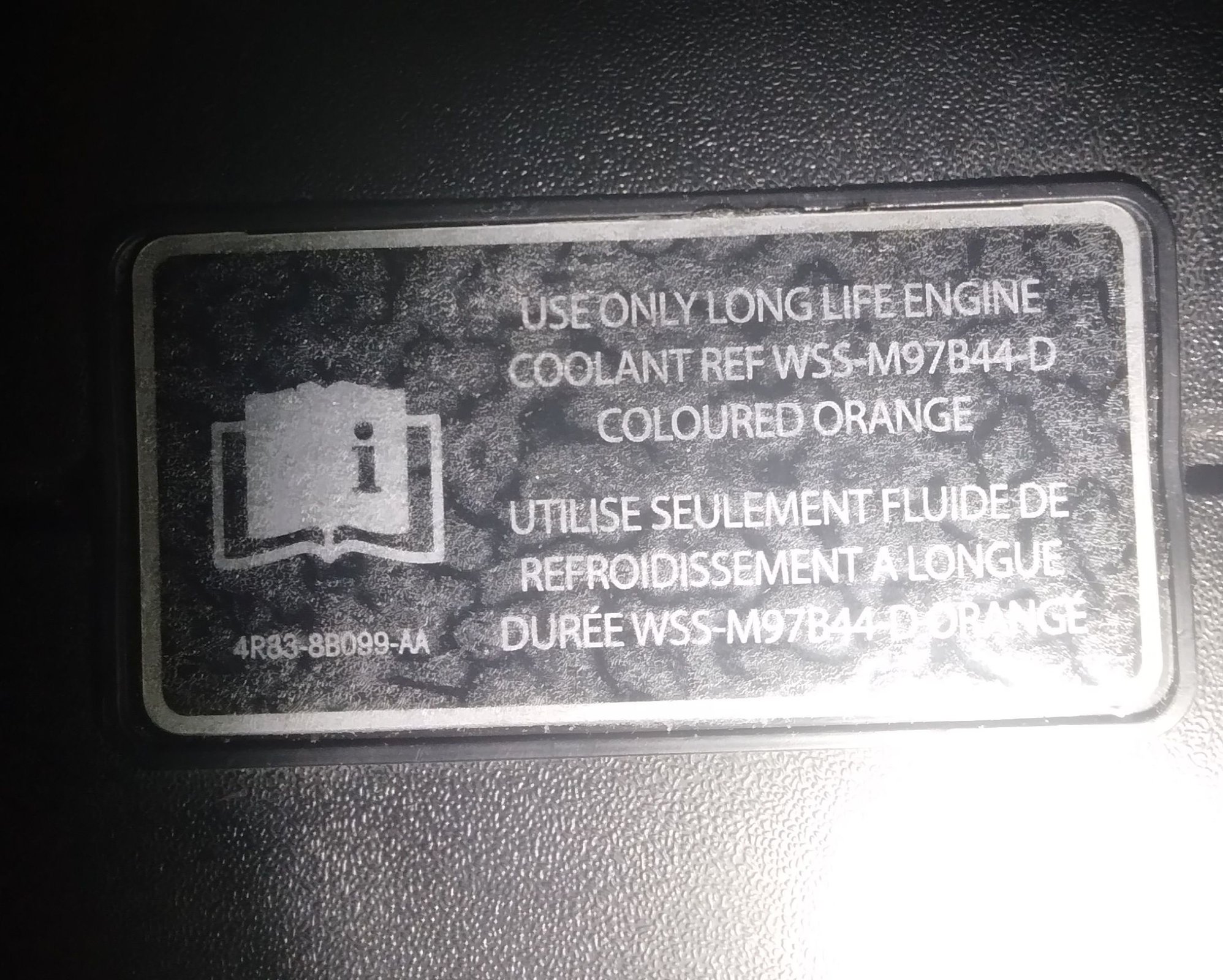

This may help - Jaguar specification WSS M97B44-D.
The coolant is orange, OAT. This label is on the coolant tank in my 2011 X351.
Coolant Label 2011 X351

Thanks. I have an orange coolant on hand that my XK8 uses - Prestone Dexcool. I'll look to see if it has that specification number.

I had 1/2 of a 5 liter container of Jaguar label orange coolant purchased from Jaguar parts left over from what I used on my old XJ8. The spec on the container is ESD M97B49-A. The Jag dealership told me it was okay to use it in my 2014 XJ 3L. I've used it once to top off.

Yes it's just plain old Dex-Cool and has been for years.
