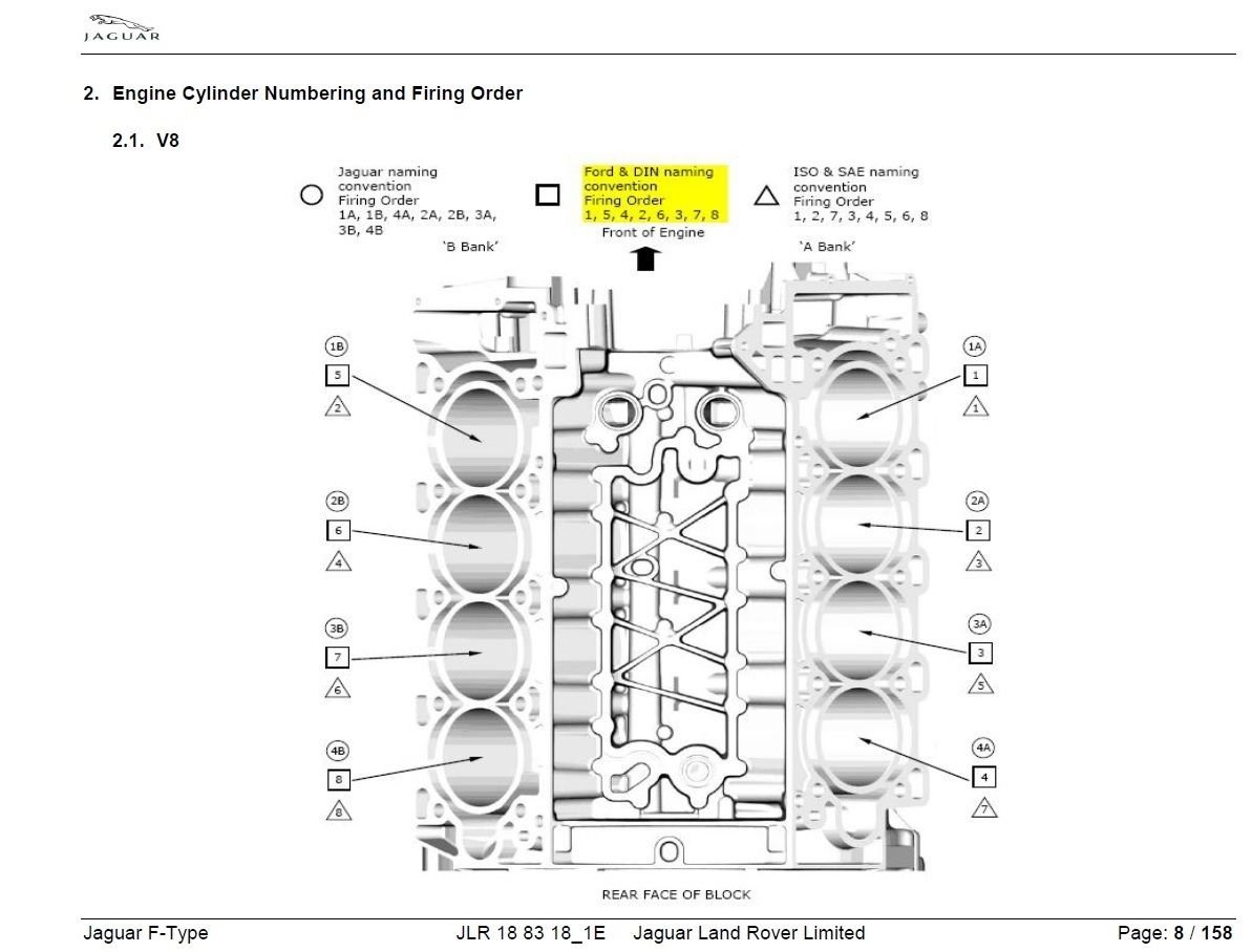

It's another confusing thing about Jaguar.
Here is a page from the service manual and you can see all the variations used over time.

The later cars, such as the X351, use the ISO numbering scheme: Bank 1 (1,3,5,7) Bank 2 (2,4,6,8).
