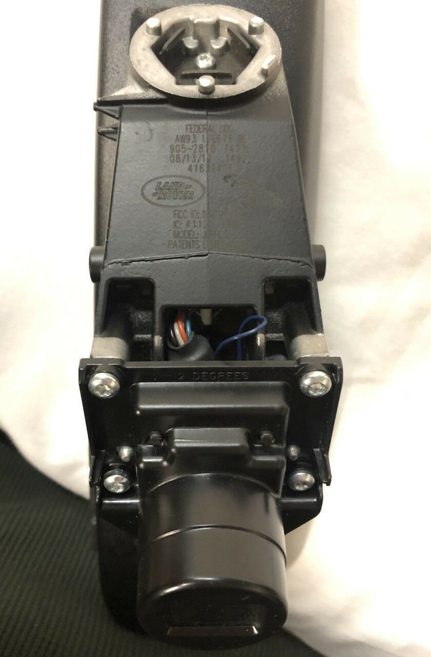

Hi guys,

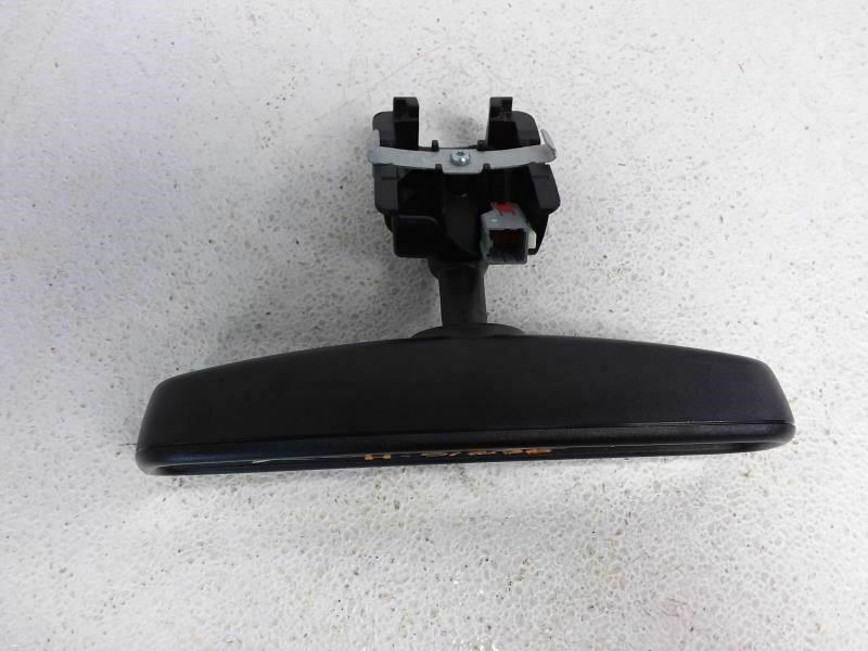

My Jag is XJL 2017MY. Unfortunately, AHBA is not available. I thought IPMA was necessary. But my Jag's windshield doesn't have IPMA. By the way, I found that the 2016-2017MY XJL can use AHBA using HCMB. It can be found in Jaguar's video, workshop manual and CCF. Rear-View-Mirror with HCMB for 17MY XJL's part number is C2D15848.
But the mount looks different. This is my XJL's.
C2D15848's mount is ..
Do I have to replace Windshield for use C2D15848 or can I use it without any replacement?
