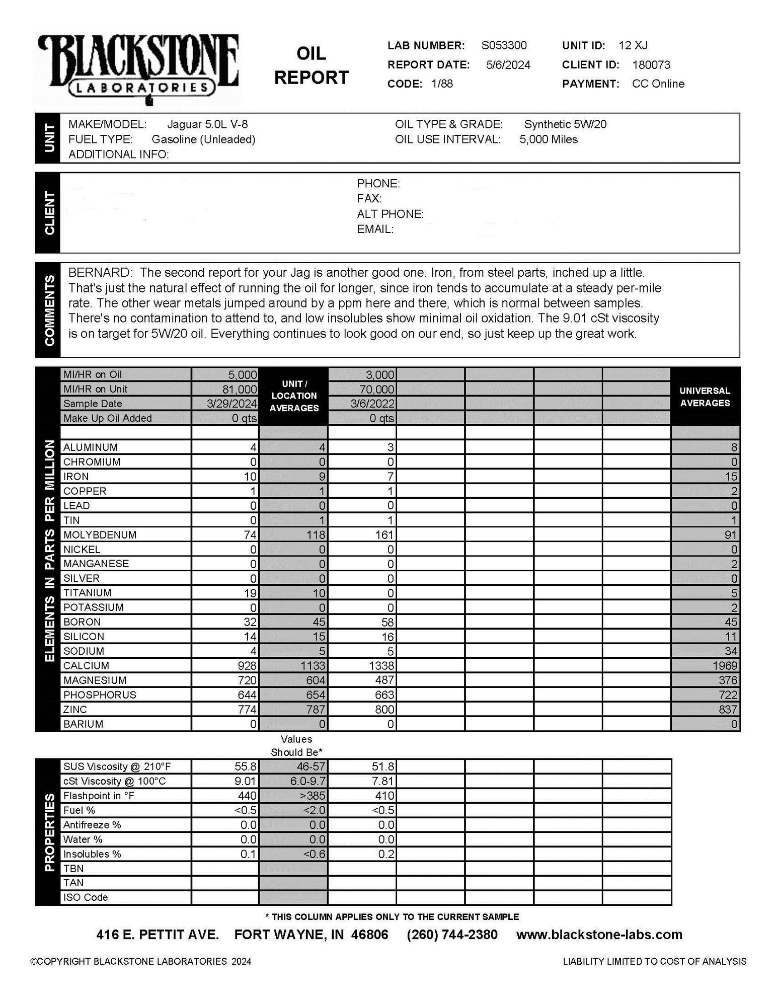

I have found the electronic oil level system on my V-8 to not be very accurate, despite following factory instructions on a flat concrete garage floor. If you're serious about engine lubrication, do the job yourself with a Mity-Vac extractor, the only definitive method to ascertain exactly how much oil you've consumed since your last oil change (the reservoir has graduated markings). Another benefit to performing the job yourself is the irrefutable knowledge of type, viscosity and amount of oil in your crankcase. You're then able to send a sample at a subsequent change for analysis. All of the tools and materials you need for an oil and filter change on these cars will cost you less than the same procedure performed once at a reputable shop.
They're not making any more of these cars, fellas, so take care of the one you've got.....
