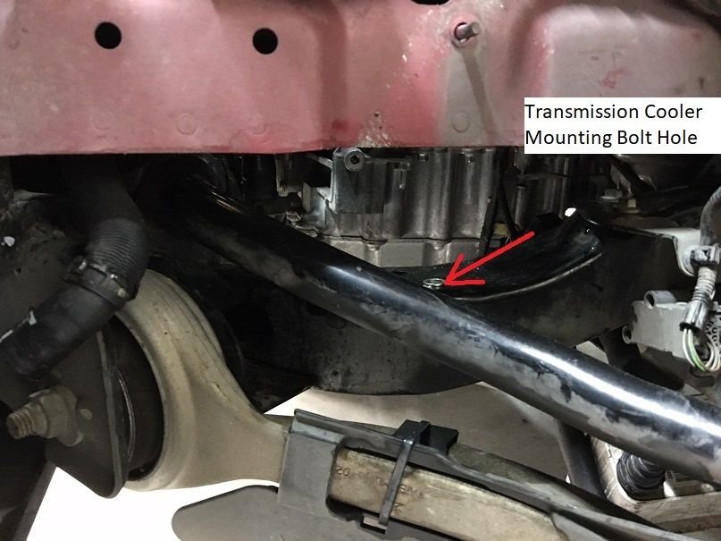

Great advice from Mark above!
I also suggest removing the plastic fender liner.
Here is my car with it removed and you can see the sway bar.

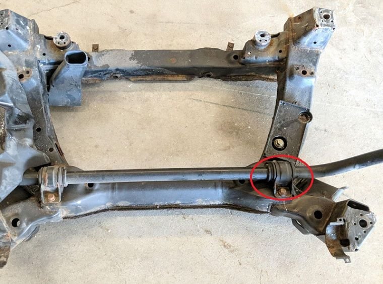

Here is a bare sub-frame so you can see where the bushing is in relation to the first photograph.
The mounting bolts are just out of sight in the top photo.
