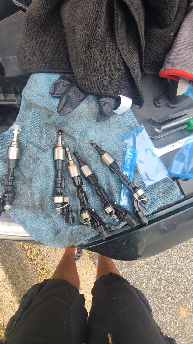

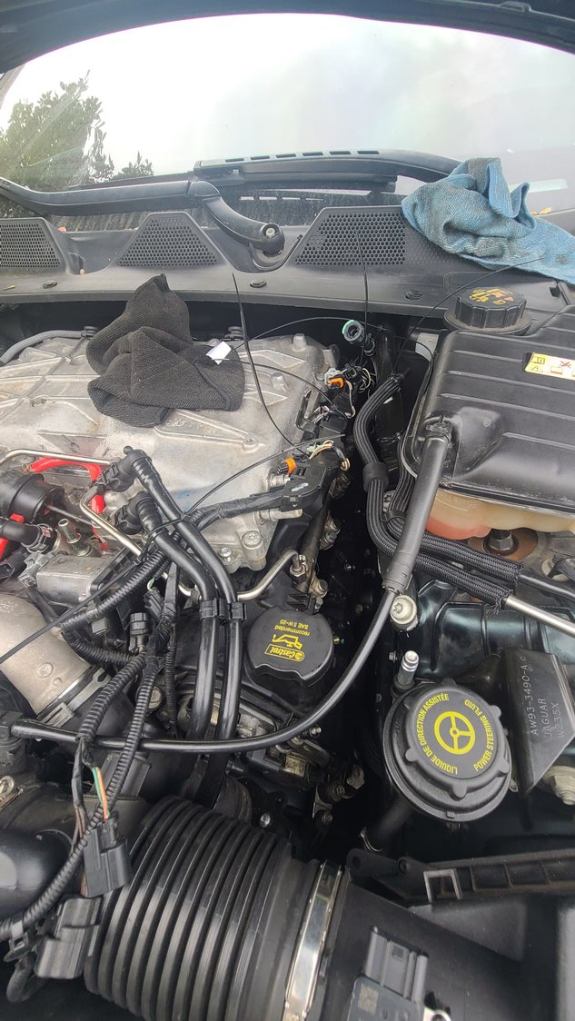

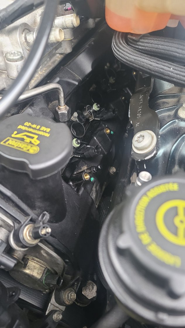

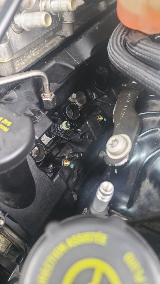

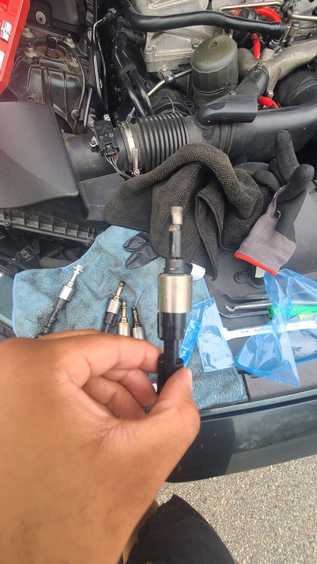

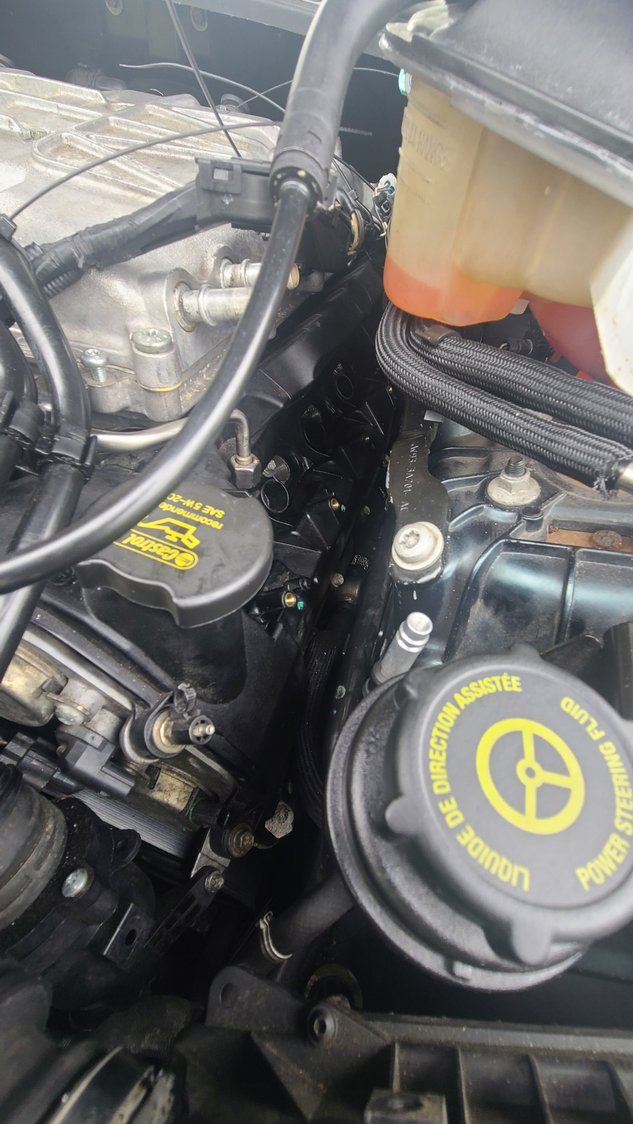

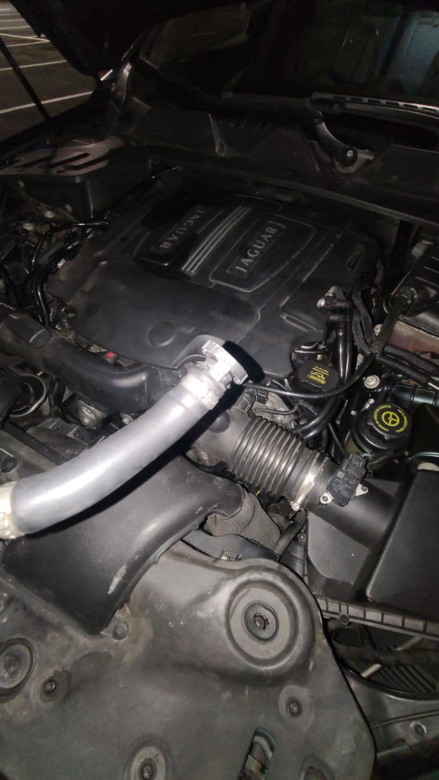

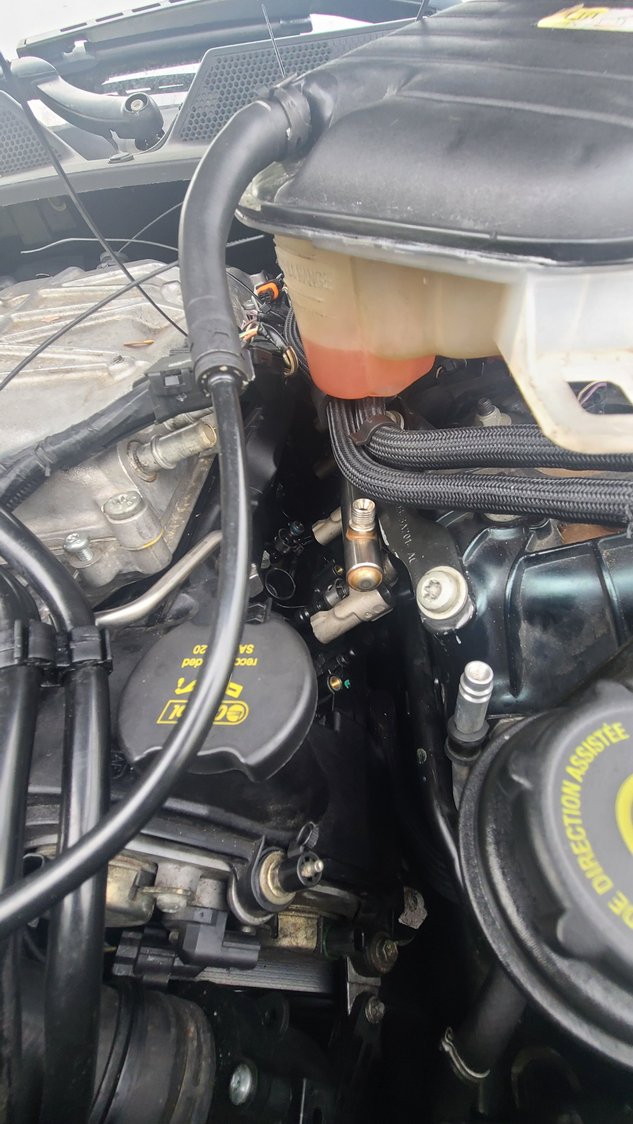

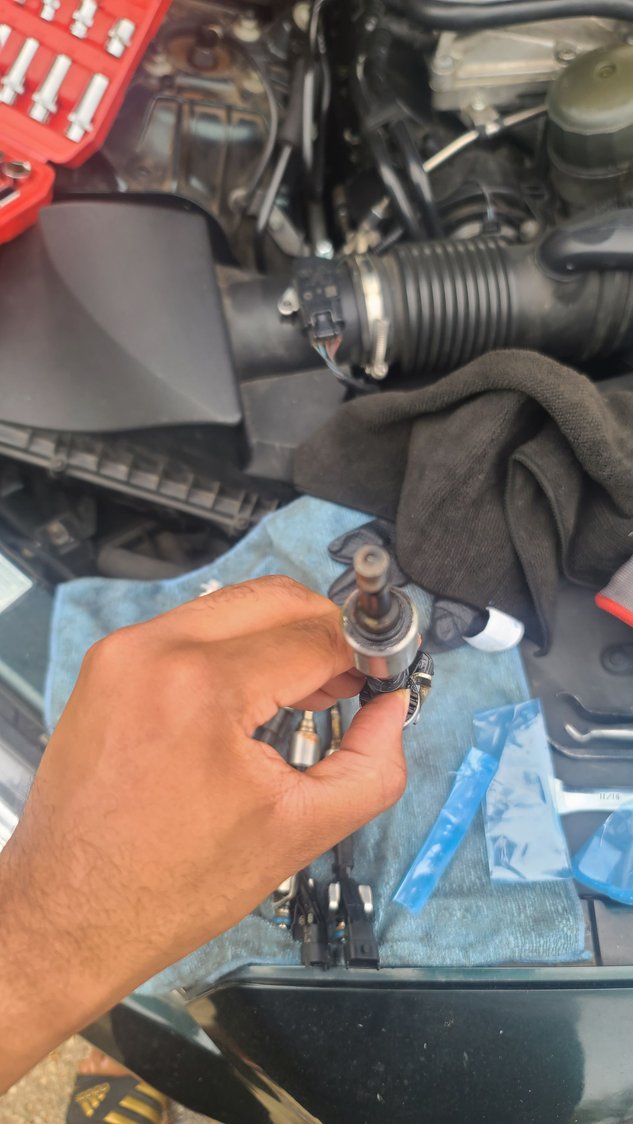

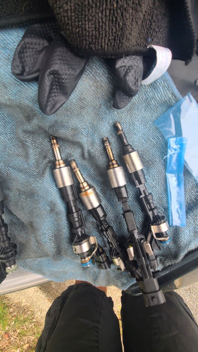

Following my posts, I've went ahead and replaced the original injectors with all new ones for bank 2 with no change. Still an imbalance. Then I thought the only iffy hose on the car was the secondary air injection that comes out the bank 2 valve cover. I replaced that where the new hose actually sealed, did the adaptation and still misfired after drive cycle.
So back to square one. Only thing I can think to do next is what you guys mentioned of either the 02 sensors or clogged cat. And less likely but could be timing which I would hope isn't the issue.
These are some photos from me doing the injector job, manage to finish the side in about an hour and 40mins on the side of a busy road.
Injectors were the originals from 2011
The last picture that is a hose that originally didn't seal so I bought a new one and no change either though there was actually a minor leak

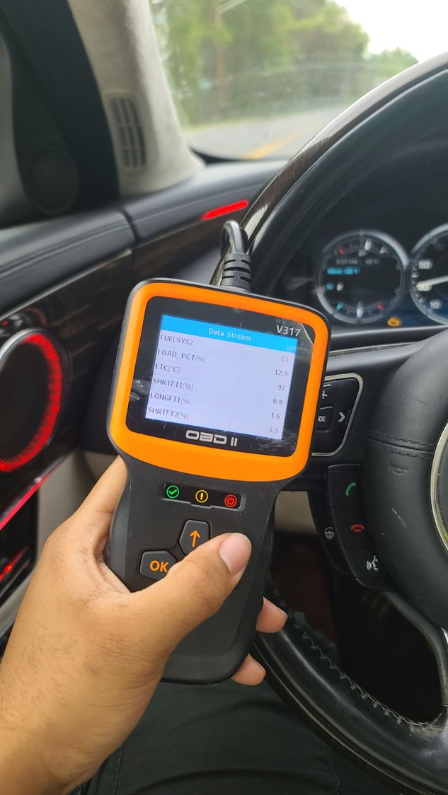

Also I use SDD to check trims I just use my small cheap one so I don't have to shuffle my laptop while driving to view trims.

Great work and great pictures!
If anyone is looking for the TSB's mentioned up thread this might help. I was sure you had an injector failure but now not so sure?
Jaguar released 2 versions of this TSB. Has anyone done this and had it fix your misfire's?
You appear to missing an AC charging port cap? Maybe took it off during the repair?

It's been missing ever since the engine rebuild. They lost a couple things to the car including my rim lol.
I was gonna put a automotive nipple seal since I couldn't find a cap. I bought a pack for my carburetor when I was modifying the vaccum petcock to a gravity petcock.

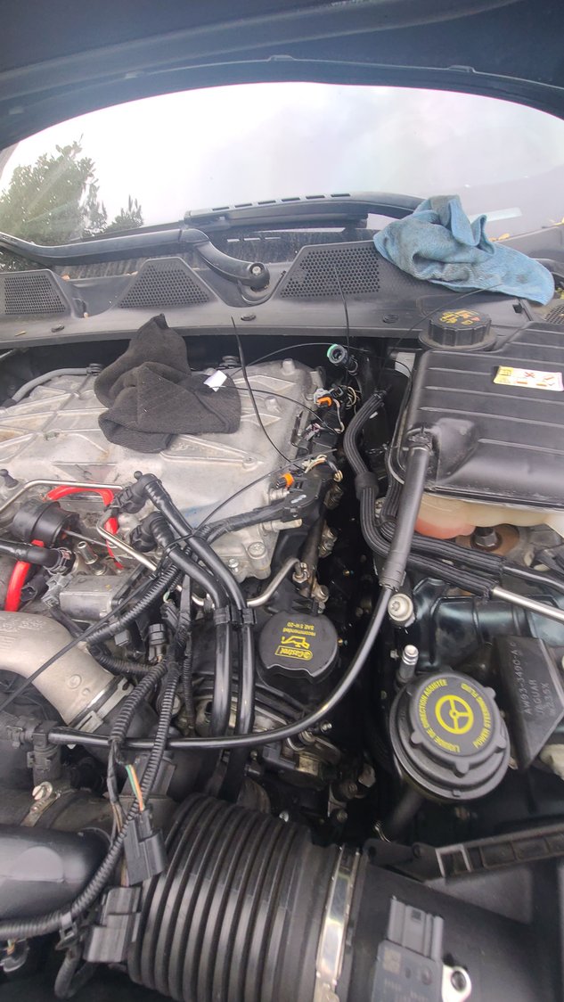

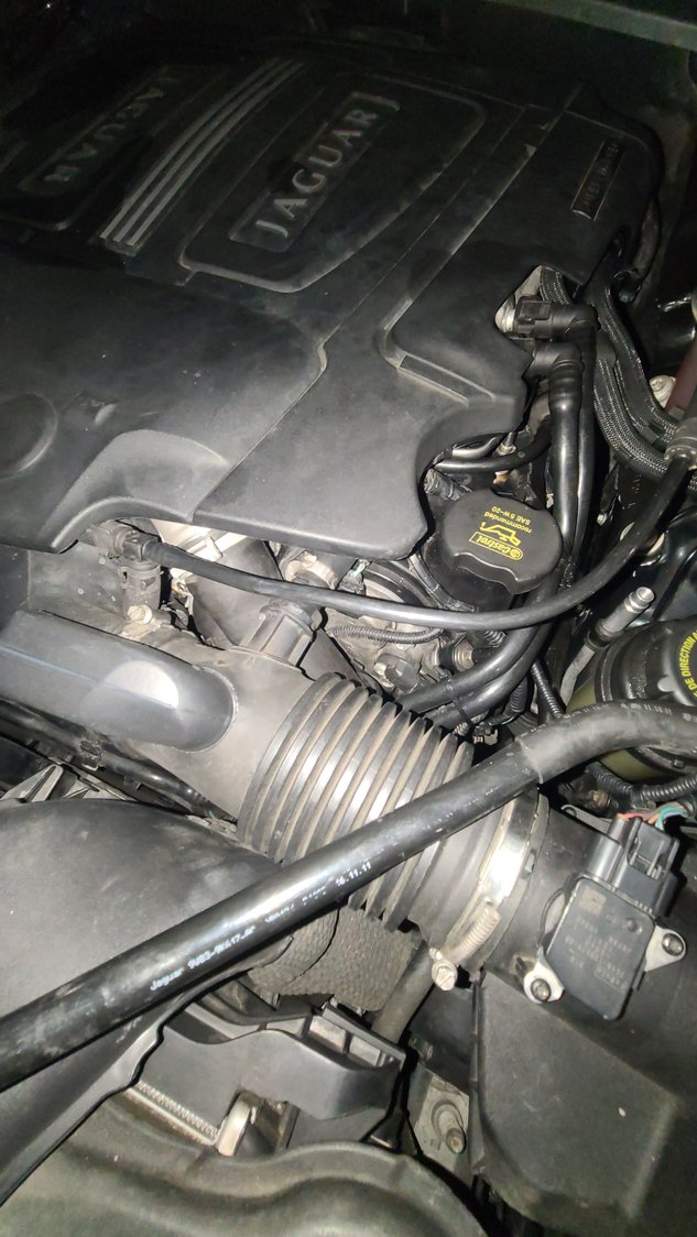

Still driving it, just still doing my research before moving to the next thing to try and solve. Or I'll say what anyone else says in reference to solutions for the misfire.
Could it be possible that the symposer can cause a vaccum leak if it were leaking? Which would cause a similar issue with the imbalance?
I'll view the cats at a later date when I get back to a lift. I still don't have any car codes or low efficiency codes

Yes, I know we're chasing dragons here (it is St George's Day), have you checked the part load breather? Pax (US) side of the engine, runs from just behind the PCV to the throttle body.
When I did the supercharger off coolant pipes refresh on the F-Pace I accidentally caught the part load vacuum pipe where it turns 90 deg around the front of the charger when putting it (the supercharger) back in.
The first time I started the engine, all was fine, the second time it ran like a bag of bolts. I moved pipes around and the idle settled back to normal, more movement would produce veryyyy erratic idle and "coughs" from the engine.
The good news is that the part is only about $35, and readily available....I'll try and dig out the part#
When I took mine off it fell apart under the fret protection around that 90 deg turn. I guess I caught it harder than I thought!
One bit of advice, if you do decide to replace the pipe, getting the pipe off the throttle body is easy, but don't waste your time with the rear connection, it's a b!t(h.. Simply snip both sides of the push tabs and pull it off.

Originally Posted by wombat
ocwolfy,
wombat
I believe I know what you're referring to, the pipe is in perfect condition and didn't leak during the smoke test. I also removed and reinstalled it was weird how its positioned at the back of the engine to the throttle body I thought to myself.
