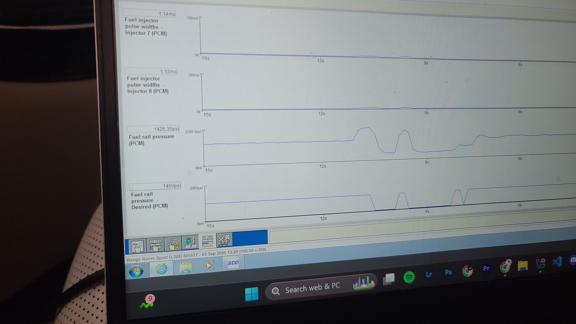

Finally got time to compare with the range Rover with the healthy engine.
Timing was the same but the fuel rail pressure is way closer to desired. And it's fully warmed up. Hits around 1400psi while mine doesn't come that close. My xj stays around 950psi.
So I think ive found the cooperate now. It's fuel

Without proper pressure the fuel do not atomize on injection and stays droplets. Droples do not burn as well as an high pressurised atomised spray.
Like i wrote earlier, the lost of cross hatch honing in cylinder walls on your pics looks like fuel wash.
Most important is that you found the issue.

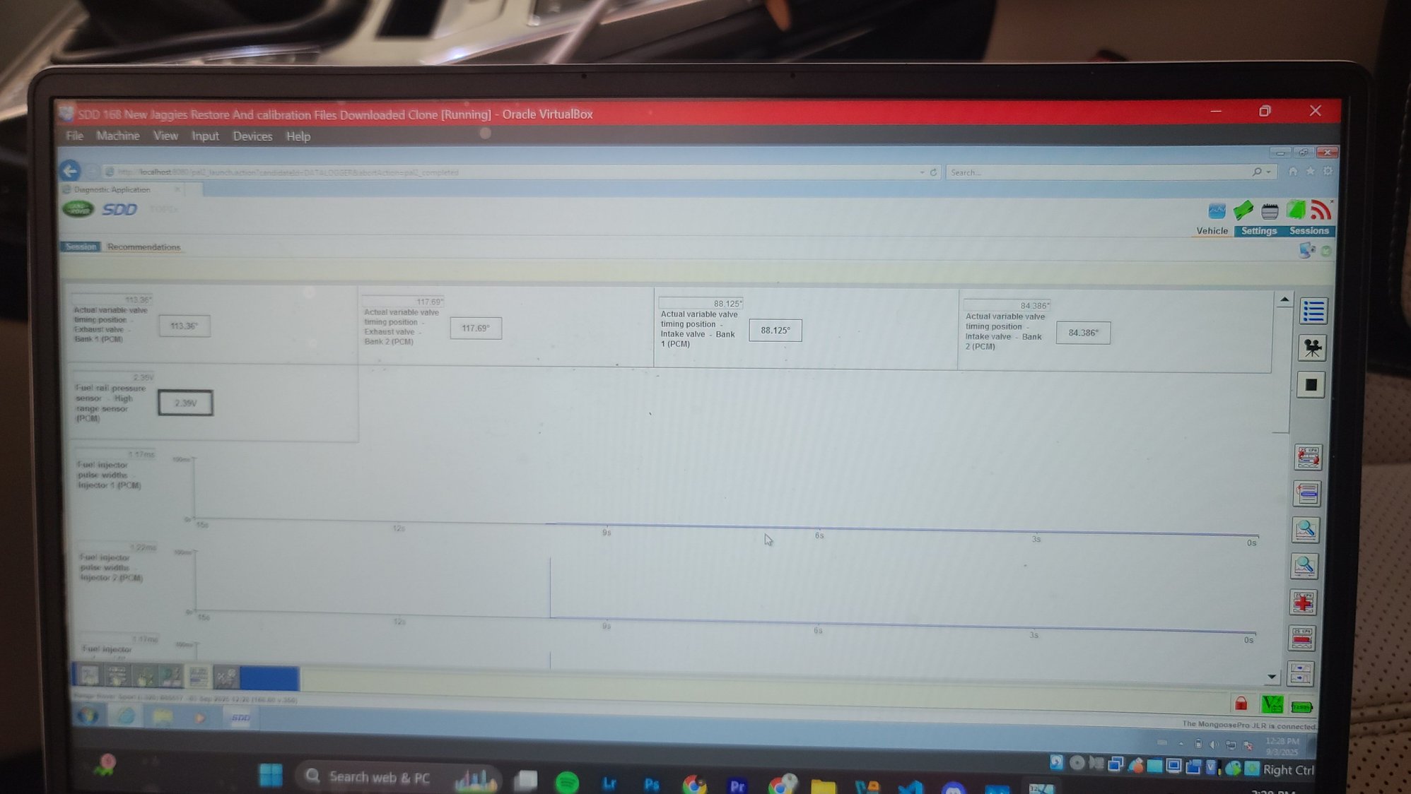

Great work using SDD! It will do a heck of lot if you know how to operate it.
As I posted above I think your problem is low fuel pressure for whatever the reason.

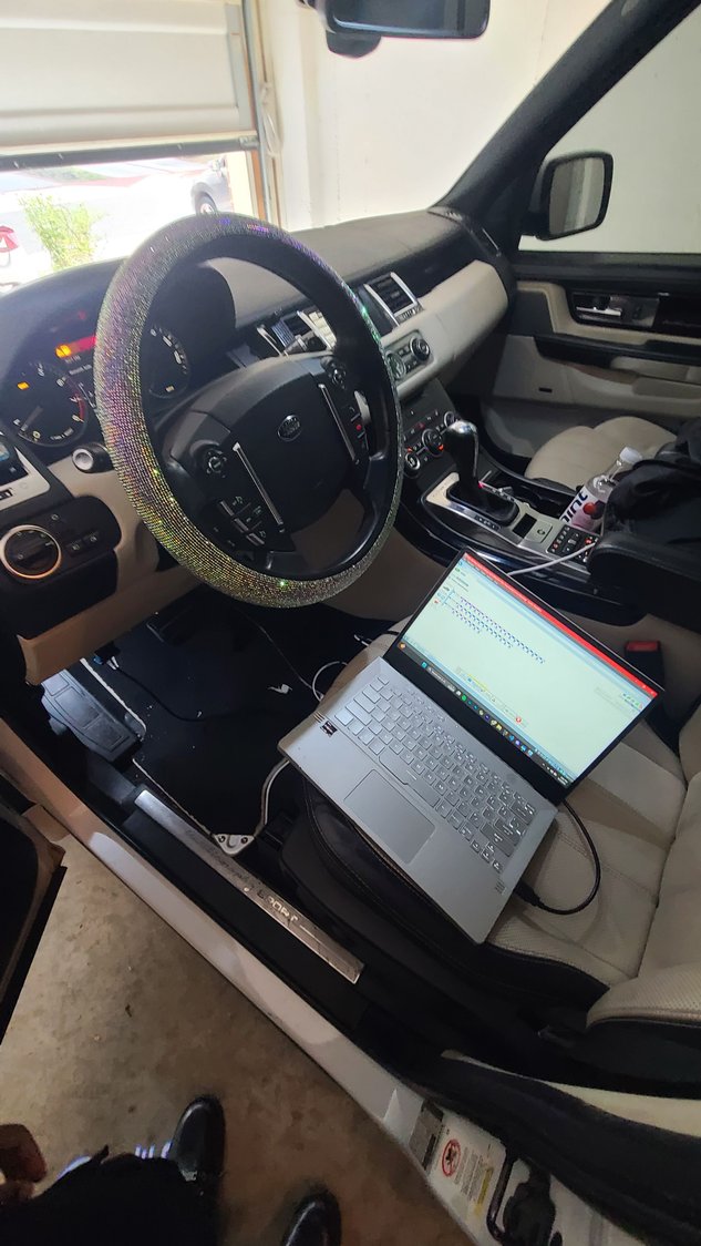

Now I will say I don't like your steering wheel cover!

Haha! Blame my mother, every car she gets she puts one on. I told her it's dangerous but she still does it. And as we all know, these JLR vehicles have heated steering so I would never put one on but hey, it's her truck😭
