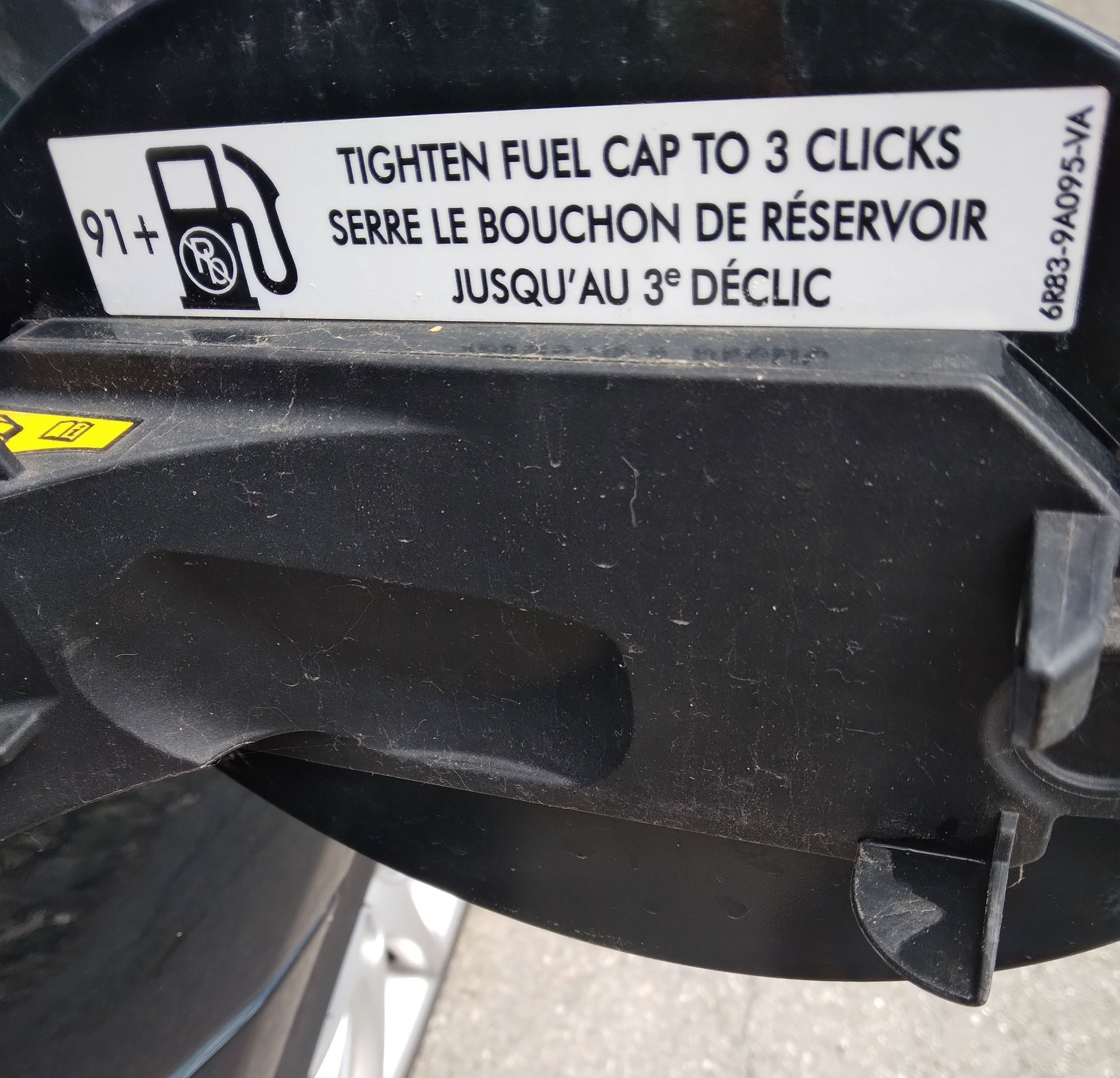

Mark,
I just went to look at the XJ fuel door and voila! - the 91+ octane sticker is there! - no excuses for my oversight.
I have owned the Xj for 6 months and I have fueled it up maybe twice now, yet I simply failed to notice that label on the fuel door.
Thanks for calling that one out, very much appreciated!

Originally Posted by britechie
Mark,
I have owned the Xj for 6 months and I have fueled it up maybe twice now yet, I simply failed to notice that label on the fuel door.
XJ fuel door label
XJ fuel door label
Glad it all worked out!

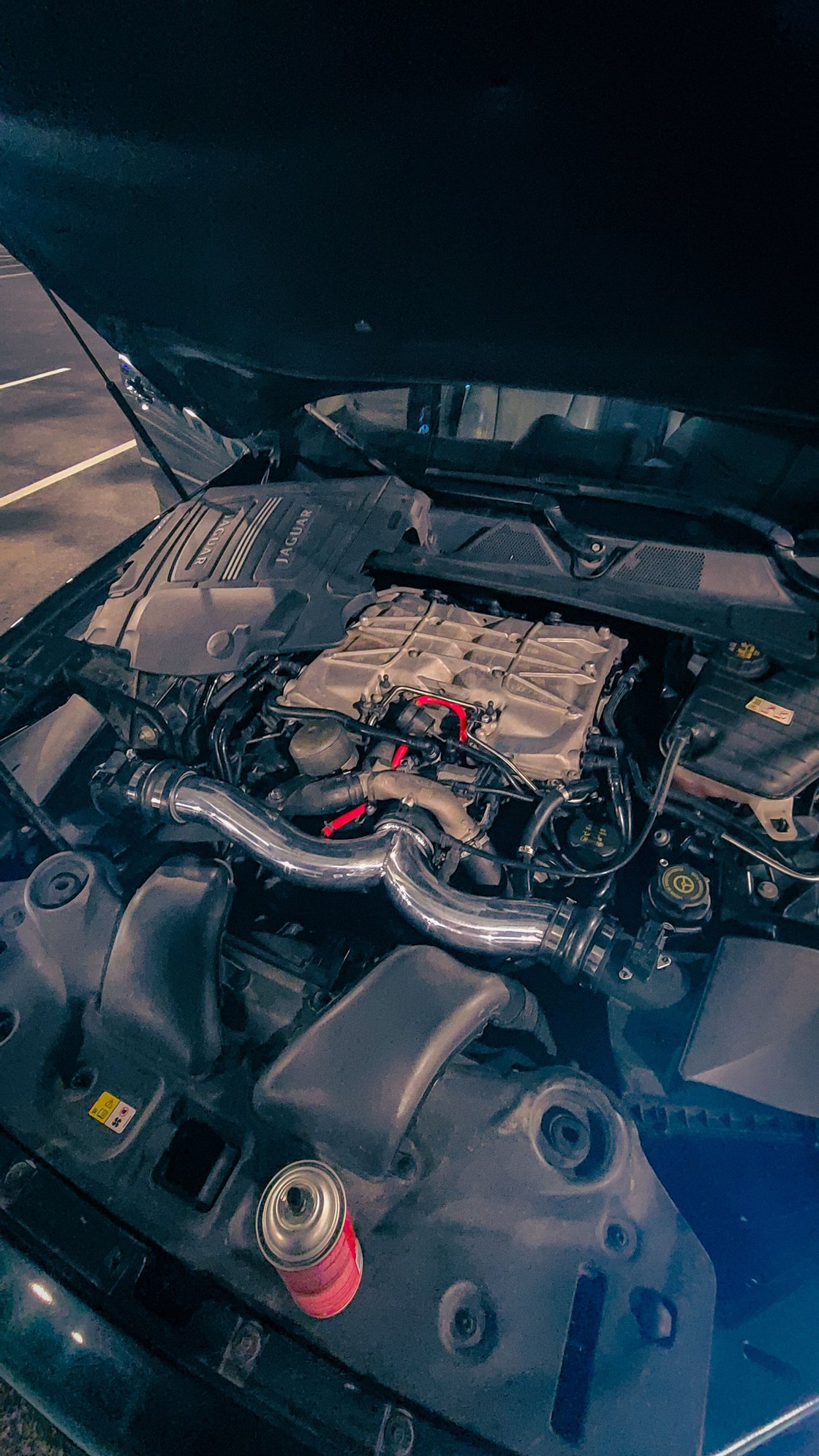

Update,
We completed the 2nd Vaccum test today and got some results.
The main intake housing to the throttle body has 2 leaks. It had three but I fixed the other one the first time (2nd air injection hose).
Where it meets the throttle body its broken and was tapped sealed. During the test some smoke still made it through the bottom. Upon removal shattered... So the mechanics did know why or why it could've been misfiring. We also used a device to test the ignition coils all were firing.
So now, I'm going to trash the old crappy plastic intake and replace it with the mina gallery aluminum version.
Another part of the intake also leaked but not sure what that angle part is called.
If after replacing it still doesn't solve it. We will move to wire harness and pcm

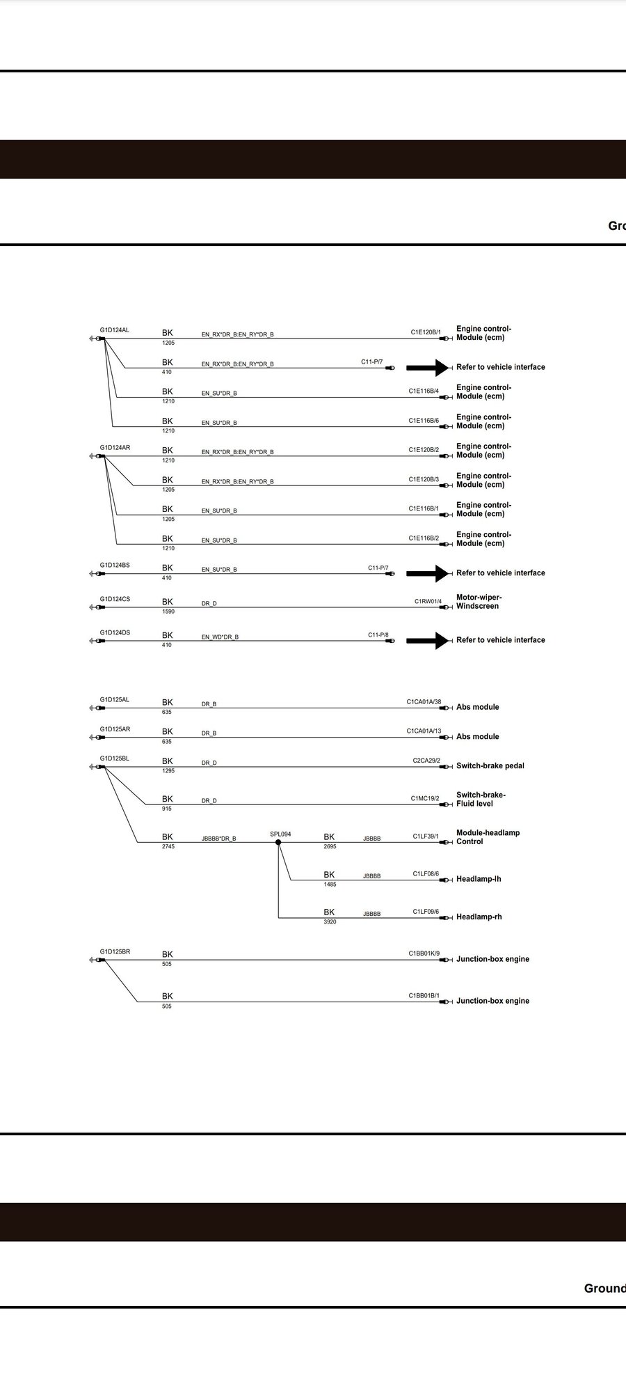

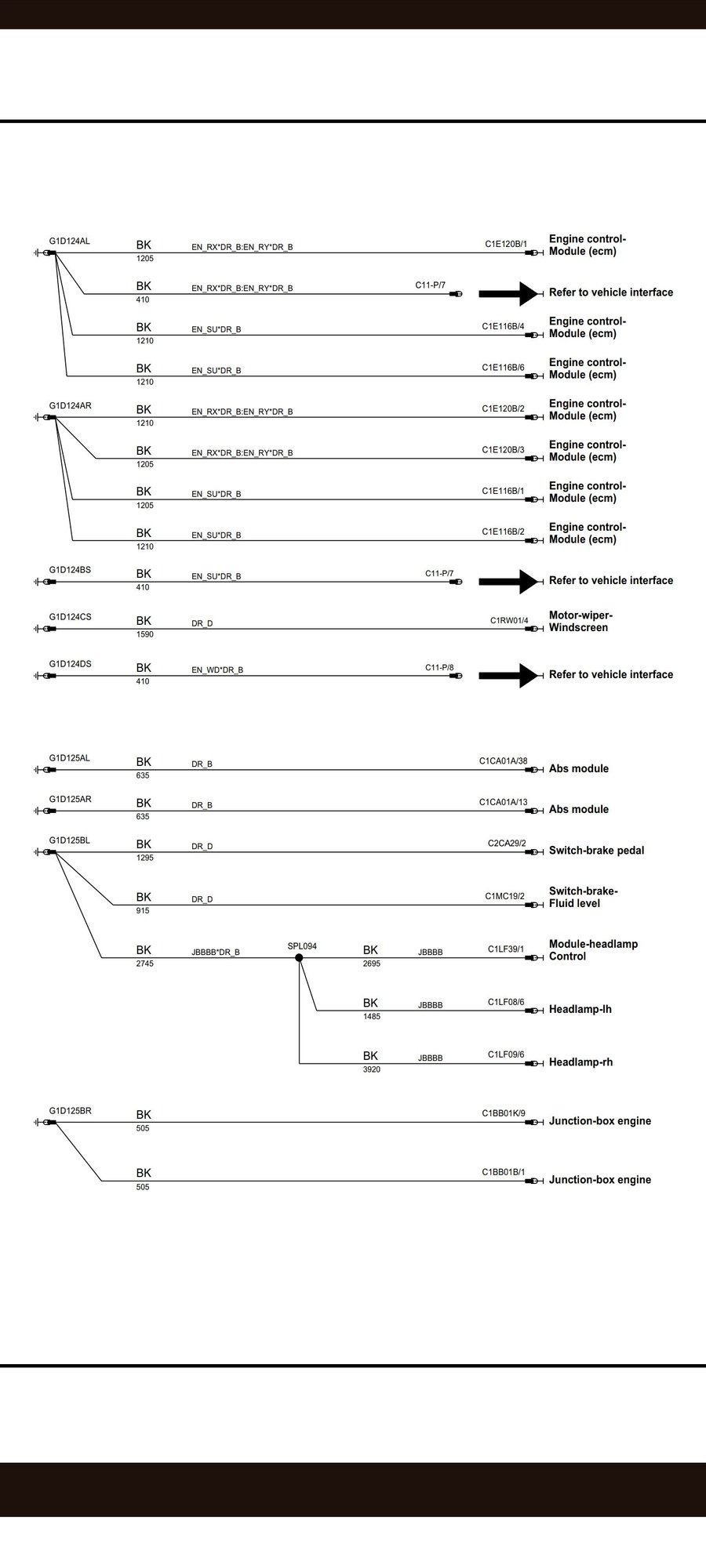

Update, so replaced the intake tube. Car had to adjust for a bit as the idle got higher as the car was used to the air leak from the other tube. Adjusted it's idle but still misfiring/vibrating.
I'll do a adaption reset when I get my laptop with SDD but it looks like the only suspect left is the PCM and wiring harness. Assuming during the rebuild they missed a ground straps it shorted the PCM after a 10min test drive
Anyone have all the ground locations for the PCM in the xj? I have the diagram but shows it for the ones on top. Sort of

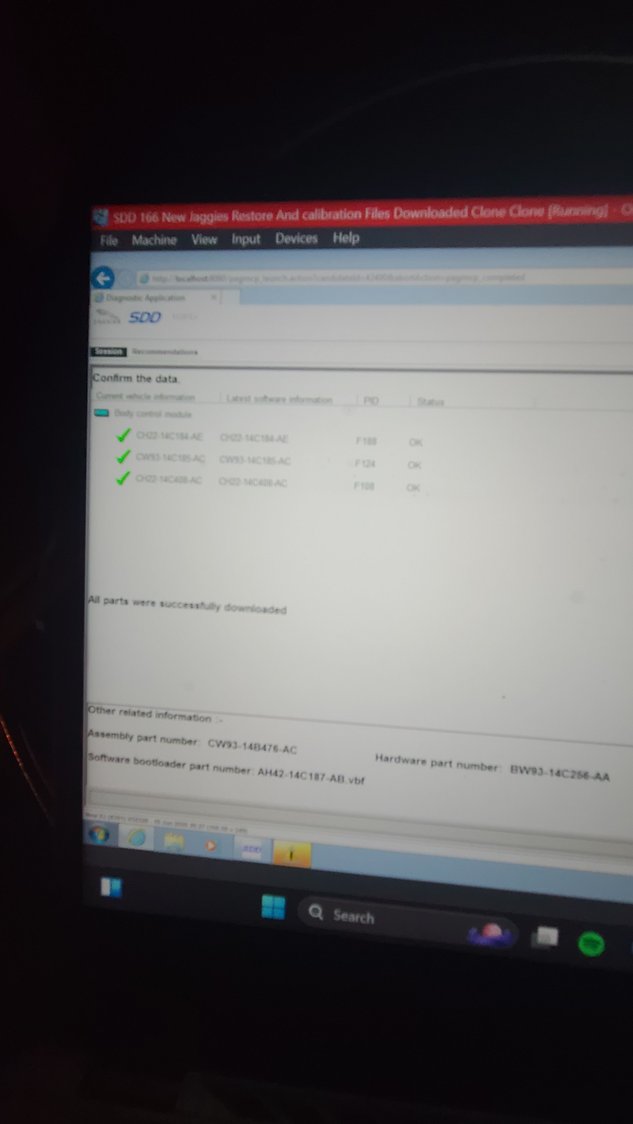

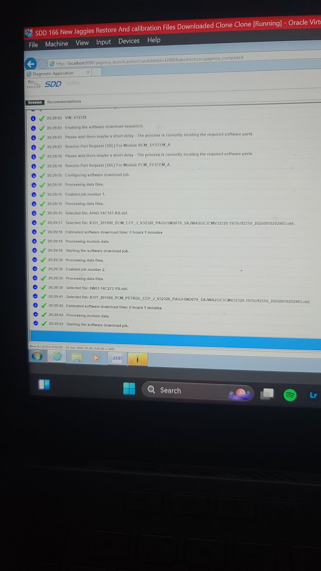

So finally had time to check the modules through sdd for corruption data and come to find out the BCM did and needed the update to be reinstalled. After this the communication errors were gone, after which I tried to update the PCM, says PCM needs no update, meaning the data is stable. So it's either there's a internal fault or the wiring. Because like previously mentioned, the engine makes excellent power, has good compression and no coolant or oil leaks or burning.
Between testing the amperage coming from the PCM and ground, is where the next step comes into.
Part of me also has a hunch I should just get another PCM and program it to the car and see what happens (yes I'm aware of the vin number situation on used ones, it's simply to test logic of if the original has a short like my xk8 did when I got it from the previous owner and to get another example after chasing an 02 code for so long) after which I'll send it in for repairs so to keep the same vin.
I don't mind spending 90$ -130$ on a used good one if it proves my idea without have to test the whole wiring harness.
