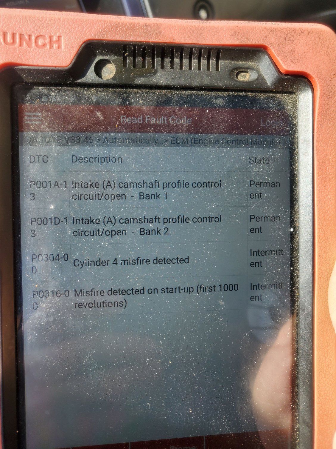

so after I rebuild my aj133 engine and get it back in the car, fire it up and the car has a rough runing
Check engine light is on reducing power message coming up
and 2 bad codes.
P001A-13 Intake (A) Cam Profile Control Circuit (Bank 1) - Circuit open (Refer to the electrical circuit diagrams and check camshaft profile switching solenoid bank 1 for open circuit)
P001D-13 Intake (A) Cam Profile Control Circuit (Bank 2) - Circuit open (Refer to the electrical circuit diagrams and check camshaft profile switching solenoid bank 2 for open circuit)
is it an electirc problom?
is it a macanical isue?
did i did somthing rwong in the timing?
can any on know where i suled start chacking?

i chack today data when the engone is runing.
cilynder 4 misfire.
cilynder 4 not working at all.
misfire in cylinder 4 rising fast.
i change the coil form 2 to 4.
fire it up and stil cylinder 4 not working.
I gat the plug out and its like new.
didnt work at all and no feiul smell at all.
and plug from other cylinder in look like its working.
so my best gess is thet the injector is not working.
Or somthibg whit the high preshure fieil pump timing is bad.
so what i shuld do next?
remove the injectors from 2 cylinders and replace them?
Mayby there is no spark?
Mayby the injector conector is bad?
what do you recomend i do next?

If I understand you correctly, you tested with plugs 2 and 4 reversed as well as the coils reversed and the issue with 4 misfiring persisted. That does suggest it is not the plug either. You can test the plug externally by just holding the stem against a ground and watching for the spark, but if the plugs worked reversed it probably isn't that.
You mention the injector connector - do you have a noid light you can test it with?
If you have one of those mechanics stethoscopes with the solid rod you should be able to touch on injector 4, even at the connector if access is tight, and hear the solenoid ticking. That won't tell you if it is blocked, but at least you'll know the electromechanical part is working.
If it sounds ok, I would avoid pulling both fuel rails to check the injectors are firing correctly because a) it is a lot of work, and b) the cross over tube is stainless steel not flexible and space is tight to do it all safely. As it is just the one cylinder misfiring it's going to be easier to just remove that single rail and swap over injectors for 2 and 4 to see if it follows. You could clean 4 when you remove it.

So i swap injector 4 whit 6 today
and the misfire has moved to cylinder 6
so it seems the injector has failed.
i order 1 new today hope it will clear all the bad codes.
