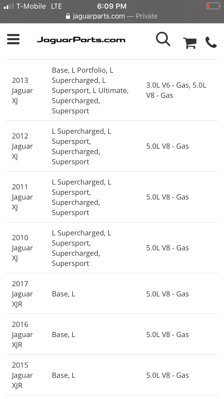

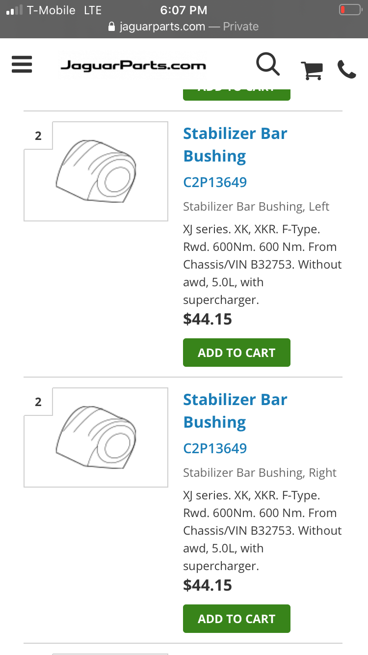

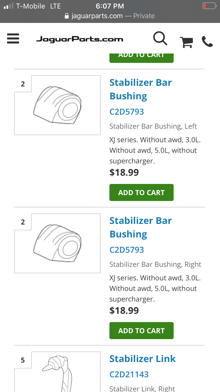

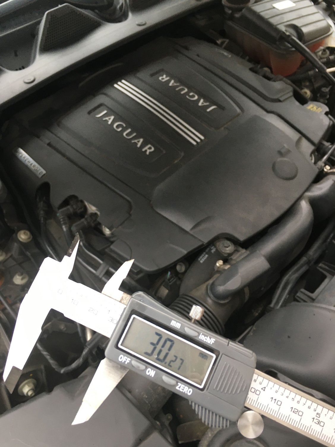

Here is my measurement to my best ability. Unfortunately the Jaguar online parts is pointing me to the bigger bar but no measurements given just applications. Same goes for the aftermarket Genuine Brand and Febi brand. I am curious as to why that is.
30.20-30.30MM more or less. Different results at the center with limited space to get the caliper there. Inside the wheel it was a little smaller read. Obviously I am assuming the bushing area diameter is the same as the center of the bar.
I will assume the XJR is 31.30?

You can see the bushings that end in 49 applies to any 5.0SC Irrespective of XJR.
I get similar results looking at the bushing in the aftermarket under the Genuine brand, which i think are simply repackaged OE parts to be sold via other retailers.
Febi only sells the smaller 3.0l bushings.
