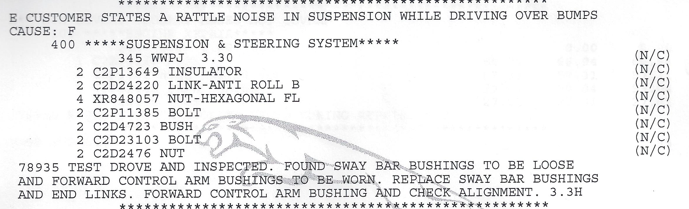

Here is what was replaced on my SuperSport when I had clunking and rattle in my front suspension and it cured the issue. This repair was over six months ago and still no issue.
